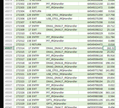

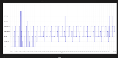

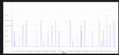

I am working with an imx.rt1020.I am using a DMA interrupt to handle microphone and another to handle a speaker, while it is connected to the computer. After a few code changes, it stopped responding as expected. When I make any change to the code such as adding a nop it resume working properly.
So, I use the trace tool to identify what was happening and I notice that the interrupt have the same duration but it is not returning to the main and it stays util it hits a new interruption. The last is the time past since the last event in microseconds.
When I change something in the code, such as changing a pin state or just add a nop it "fix" the behavior.
I want to know what is holding the program.
If someone can help me identify what is happening.

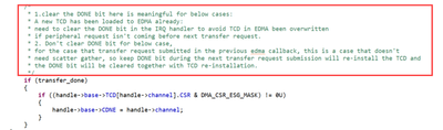

Hui_Ma
I am not sure if customer is using MCUXpresso SDK software package for RT1020 product.
There with below comment about clear eDMA TCD DONE bit before exit interrupt handling routine:
Wish it helps.

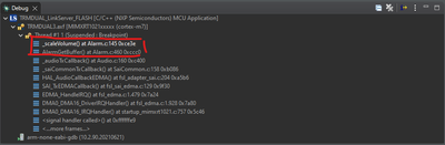

luizsantana
This picture shows the functions stack inside of the eDMA interrupt. I highlighted the two functions that were not in a non-cacheable memory, when I moved them to a non-cacheable memory the problem stopped.
Can this be the root cause? Is there a document that explains the cache and how to avoid this kind of problem?
