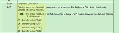

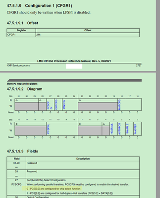

  I checked the LPSPI IP module, from the register, just can select one PCS pin:
TCR register:
If you want more than one pin as the SPI_CS function.
Just the LPSPI IP hardware, no register to select it.
So, maybe still need to use the GPIO method.
