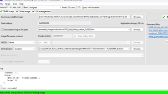

Hello Support team,
I am currently utilizing the RT1176 EVK for our testing purposes.
Following the guide provided at the link below:
https://community.nxp.com/t5/i-MX-RT-Knowledge-Base/RT1050-SDRAM-app-code-boot-from-SDcard-burn-with...
While there were no issues encountered during the utilization of MCUBootUtility and SecureProvisioning, I am experiencing difficulties with the LED blinking functionality.
Could you please assist me in identifying and resolving the underlying issue?

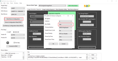

This issue is now solved : by setting the bus width of the SD card option to 4bit, which corresponds to SW2 Pin10 being set to 1. (1bit seems to be having some issues at the moment and is being troubleshooted internally, so we'd recommend you use it this way for now)
I tested it using MCUBootUtility with the following configuration:
For SD card boot and 4bit bus width, we need to pull Pin7 and Pin10 of SW2 high.
Gavin
Gavin
