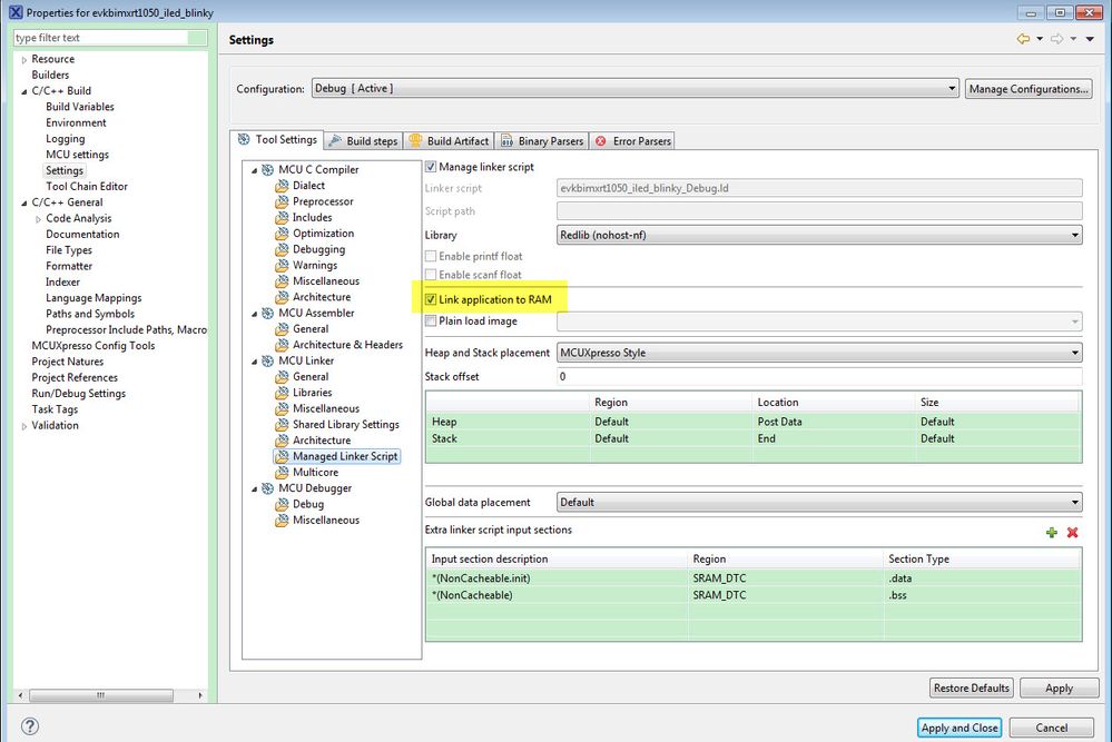

2.1 Copy code to RAM
2.2  Modify memory location to SDRAM address 0X80002000

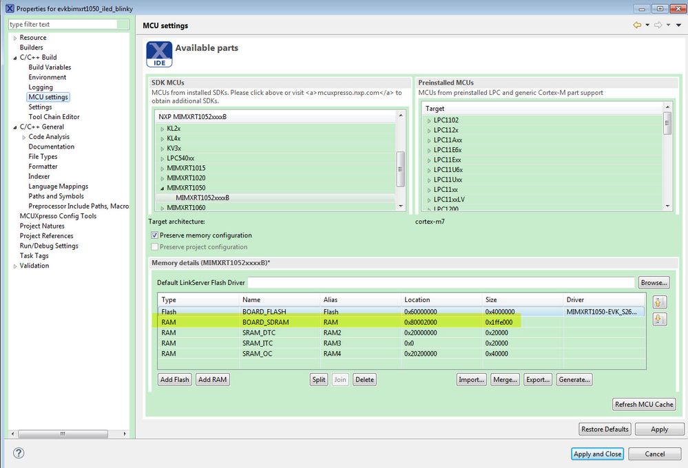

The code which boots from SD card and running in the SDRAM is the non-xip code, so the IVT offset is 0X400, in our test, we put the image from the SDRAM memory address 0x800002000, the configuration is:

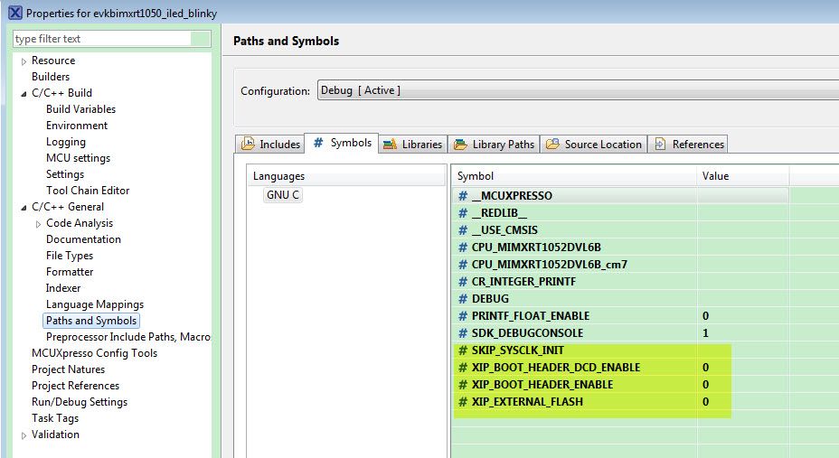

2.3 Modify the symbol

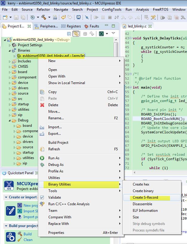

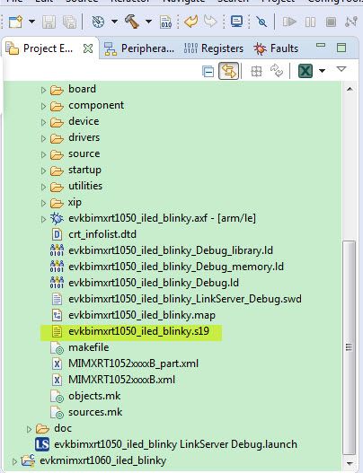

2.4 Generate the .s19 file
     After build has no problems, then generate the app.s19 file:
Rename the app.19 image file to evkbimxrt1050_iled_blinky_sdram_0x2000.s19, and copy it to the flashloader folder:

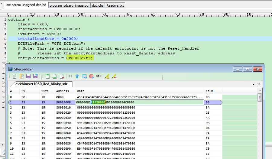

3.2 imx-sdram-unsigned-dcd.bd file
Prepare the imx-sdram-unsigned-dcd.bd file content as:
options {
    flags = 0x00;
    startAddress = 0x80000000;
    ivtOffset = 0x400;
    initialLoadSize = 0x2000;
    DCDFilePath = "CFG_DCD.bin";
    # Note: This is required if the default entrypoint is not the Reset_Handler
    #       Please set the entryPointAddress to Reset_Handler address
    entryPointAddress = 0x800022f1;
sources {
    elfFile = extern(0);
section (0)
 The above entrypointAddress data is from the .s19 reset handler(0X80002000+4 address data):

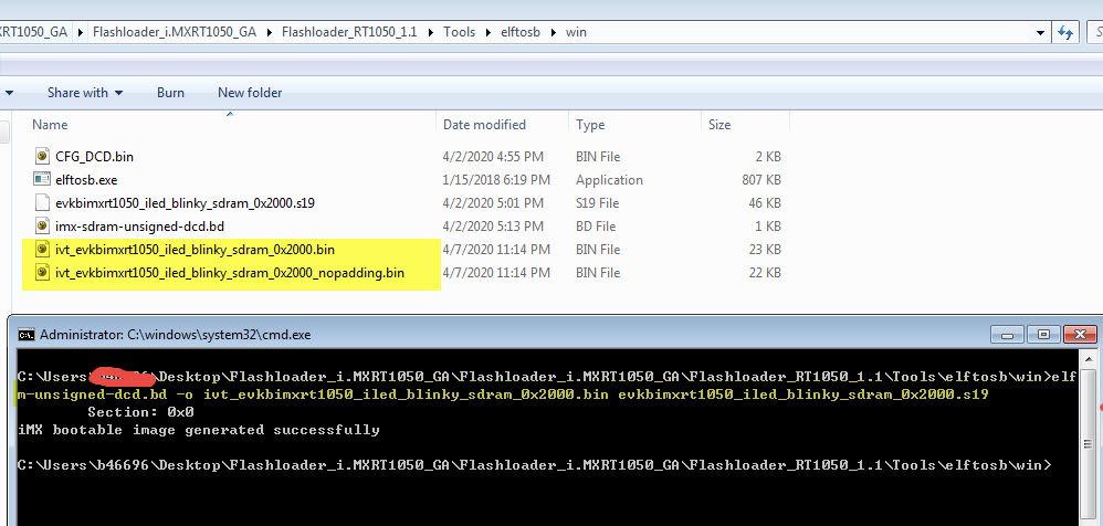

Open cmd, run the following command:
elftosb.exe -f imx -V -c imx-sdram-unsigned-dcd.bd -o ivt_evkbimxrt1050_iled_blinky_sdram_0x2000.bin evkbimxrt1050_iled_blinky_sdram_0x2000.s19
After running the command, two app IVT files will be generated:

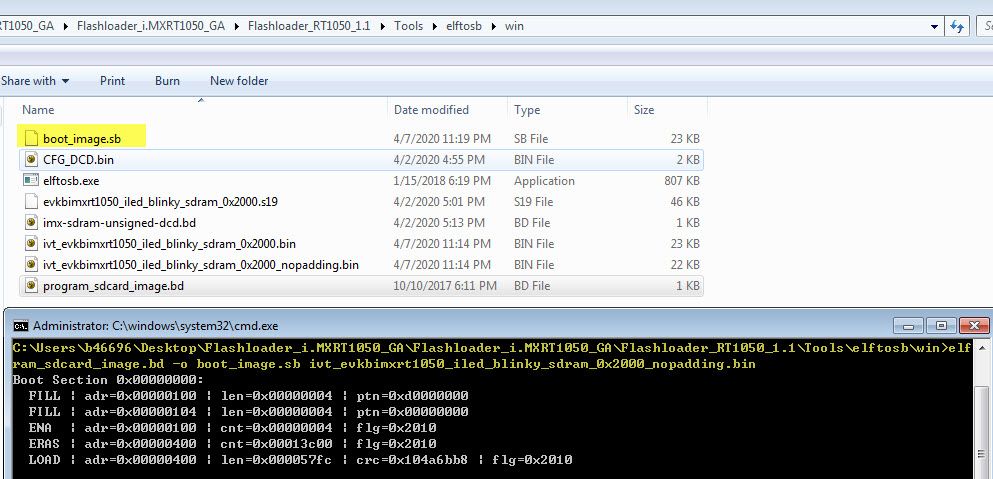

Copy program_sdcard_image.bd to the flashloader path:
Flashloader_i.MXRT1050_GA\Flashloader_RT1050_1.1\Tools\elftosb\win
elftosb.exe -f kinetis -V -c program_sdcard_image.bd -o boot_image.sb ivt_evkbimxrt1050_iled_blinky_sdram_0x2000_nopadding.bin
Copy the generated boot_image.sb file to the following flashloader path:
\Flashloader_i.MXRT1050_GA\Flashloader_RT1050_1.1\Tools\mfgtools-rel\Profiles\MXRT105X\OS Firmware

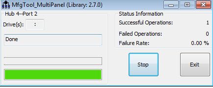

3.4 MFGTool burn code to SD card
   Prepare one SD card, insert it to J20, let the board enter the serial download mode, SW7:1-ON 2-OFF 3-OFF 4-ON. Find two USB cable, one is connected to J28, another is connected to J9, we use the HID to download the image.
   Open MFGTool.exe, and click the start button:

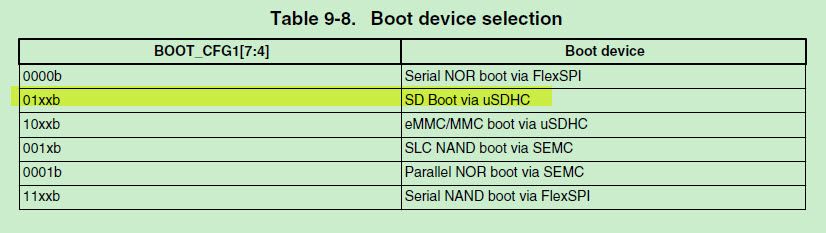

   Modify the boot mode to internal boot, and boot from the external SD card, SW7:1-ON 2-OFF 3-ON 4-OFF.
     Power off and power on the board again, you will find the onboard LED D18 is blinking, it means the external SDRAM APP code is boot from external SD card successfully.

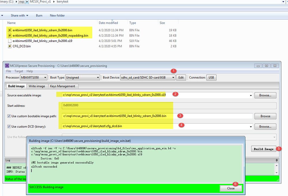

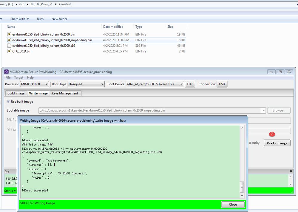

5, MCUXpresso Secure Provisioning configuration and download
  This software is released in the NXP official website, it is also the GUI version, which can realize the normal code and the secure code downloading, it will be more easy to use than the flashloader tool, customer don’t need to input the command, the tool help the customer to do it, the function is similar to the MCUBootUtility, MCUBootUtility tool is the opensource tool which is shared in the github, but is not released in the NXP official website.
  Now, we use the new official realized tool to download the SDRAM app code to the external SD card, the board still need to enter the serial download mode, just like the flashloader and the MCUBootUtility too, the detail operation is:
 We can find this tool is also very easy to use, customer still need to provide the app.19 and the dcd.bin, then give the related boot device configuration is OK.
   After the code is downloaded successfully, modify the boot mode to internal boot, and boot from the external SD card, SW7:1-ON 2-OFF 3-ON 4-OFF.
  Until now, all the three methods to download the SDRAM app code to the SD card is working, flashloader is the command based tool, MCUBootUtility and MCUXPresso Secure Provisioning is the GUI tool, which is more easy to use.
