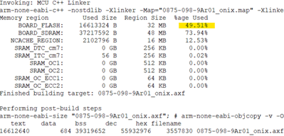

I'm using a RT1176 in a custom board with SDRAM and a IS25WP128-JBLE QSPI external flash.
We are doing a HMI, and the flash size is getting small for including images in flash, so we changed the flash to IS25WP256D-JLLE.

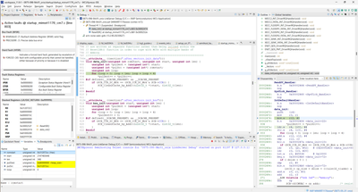

When the code is less than 50% of the flash size, all is working fine, but when we start using the "new sectors" we get a hard fault in data_init.
I changed the board flash size in board.h and a line in board.c

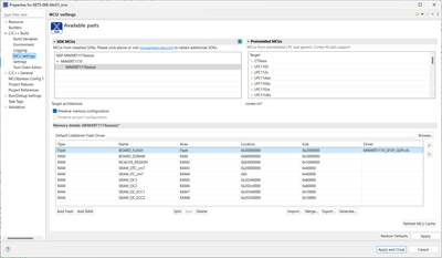

Also changed the size in MCU settings:
Maybe the cfx driver is not valid?
I need to do more steps?

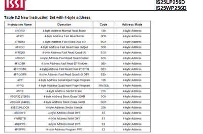

Hello EdwinHz,
I tried the example code, and changing the flash size it seems to work in the upper part of the FLASH:
I changed lookupTable in evkmimxrt1170_flexspi_nor_config.c with the customLUT provided, but it's not working yet.
Maybe it's important to remark that my program is working fine until the mid region of the flash. When the % used of the memory surpases the 50%, it fails.
I was thinking about the instructions for managing 4-byte address, but it's not included in customLUT, and the example seems to work without that:
