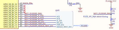

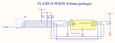

I have a second iteration of my board with an RT1062 and an IS25WP256D-JLLE. I have the following issue:

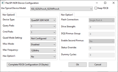

I try to connect to the board through the bootloader (Serial bootload from MCUBootUtility (v3.4)) I get the following error:
These are the settings that I am using (these settings worked with the previous iteration of my board with an IS25WP064A-JBLE):

• This is the schematic (same pins selected as the previous version):

The main difference between IS25WP064A and IS25WP256D is address range. IS25WP256D supports 4bytes address.
Do you have chance to run \SDK_2_12_0_EVK-MIMXRT1060\boards\evkmimxrt1060\driver_examples\flexspi\nor\polling_transfer demo? What's the result?
And also you can try to use 1bit SDR flash model in MCUBootUtility to configure this flash, see section 2.3 in https://www.cnblogs.com/henjay724/p/12984020.html

In the meantime, is there a good source/tutorial on how to create/modify an FDCB configuration (most helpful would be through NXP-MCUBootUtility as it seems easier for now).
Do you have a known working FDCB config for the specific flash (IS25WP256D-JLLE)?
As this is the 1st time working with FDCB, any help will be really appreciated!

FDCB is complicatied , It's hard to explain it in a nutshell.
Below FDCB should be working for IS25WP256D (It is 1bit SDR mode)
\NXP-MCUBootUtility-3.5.0\src\targets\fdcb_model\cfg_fdcb_RTxxx_1bit_sdr_flashA.bin
