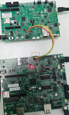

I'm using the MIMXRT1170-EVKB starter kit and trying to get the CAN bus working. I loaded the "evkbmimxrt1170_canfd_loopback_transfer_cm7" example, but I need to be able to receive any CAN frame on the bus (both standard and extended frames) without loopback or filtering. Can someone explain how to modify the example to achieve this? I tried setting the global mask to 0 and same for the RX message buffer slot id, but nothing is being received.

Hi @PaoloRB,
Thank you for your updated information.
I advise you not to use the “evkbmimxrt1170_canfd_loopback_transfer_cm7” SDK demo, this example is about send a CAN Message from the Tx Message Buffer to the Rx Message Buffer through internal loopback interconnect.
I use MIMXRT1050-EVKB board and MIMXRT1070-EVKB board.
I import SDK demo "evkbimxrt1050_flexcan_interrupt_transfer"  and "evkbmimxrt1170_canfd_interrupt_transfer_cm7".
I modify some code, the result is that MIMXRT1170-EVKB can receive any CAN ID send from MIMXRT1050-EVKB board.
1:  flexcanConfig.enableIndividMask = false;
2: FLEXCAN_SetRxMbGlobalMask(EXAMPLE_CAN, 0);
If you use MIMXRT1170-EVKB board CAN3 J47, Please Remove J102 and J103 jumpers. It is very import.
Please connect Two CAN interface correctly.
Wish it helps you.

J102 and J103 jumpers were the issue. Really appreciated
