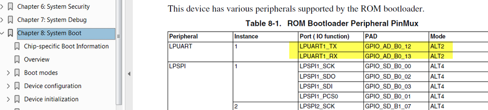

 How to flash imxrt 1064 internal flash using UART1 ?
   Thanks & Regards
           Vasu
2,753 次查看
kerryzhou
Hi Vasudhevan G,
   You need to enter the serial download mode at first, then use the following UART pins to connect your RT chip and donwload it.pastedImage_1.png
About the download,  I suggest you use our MCUBootUtility tool to download it, it's very easy to use:
https://github.com/JayHeng/NXP-MCUBootUtility/releases/tag/v2.1.0
the related user manual is:
You can try it at first.
If you still have questions about it, please kindly let me know.
Wish it helps you!
Kerry
