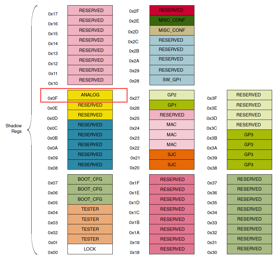

The imx1060 fusemap (ref-manual chapter 22) is confusing me, so I could use some clarification...
Seems the fusemap chapter goes into a lot of detail regarding fuse addresses (ranging from 0x400 - 0x8c0) and their bits; but there is no discussion regarding how to access that address range.  Then chapter 23 (OCOTP) seems to say that the OCOTP is the mechanism used to access the fuse map.  Referring to the SDK's OCOTP code, I can use OCOTP_Init(), OCOTP_ReloadShadowRegister()OCOTP_ReadFuseShadowRegister() and OCOTP_WriteFuseShadowRegister() to read/write the fuses; but I don't understand how the address passed to OCOTP_ReadFuseShadowRegister() corresponds to some entry in the fusemap.
Based on the "OTP Memory Footprint" (Figure 23-2 in ref manual), there are several "not-reserved" shadow registers that can be accessed as follows:
0x00:   LOCK
0x05:   BOOT_CFG
0x06:   BOOT_CFG
0x07:   BOOT_CFG
0x0F:   ANALOG
0x20:   SJC
0x21:   SJC
0x22:   MAC
0x23:   MAC
0x24:   MAC
0x26:   GP1
0x27:   GP2
0x28:   SW_GP1
0x2D:   MISC_CONF
0x2E:   MISC_CONF
0x38:   GP3
0x39:   GP3
0x3A:   GP3
0x3B:   GP3
Do each of these registers somehow correspond to entries fusemap?  If yes, how?  If no, what am I missing?
Are the functions I mention above the correct hooks into the fusemap?

Hi Ed,
I think I understood your confusion. For the explanation, I will take as an example the ANALOG group that is at location 0x0F.
In section 23.6.1.24.2 of the reference manual, you will find the shadow register that corresponds to this word.
Here, you can see that the offset of this register is 4F0. If you go to the Fusemap Descriptions Table, you will see that address 0x4F0 corresponds to the USB VID and USB PID.

victorjimenez
Hi Ed,
Victor
- If this post answers your question, please click the "Mark Correct"button. Thank you!
9,400 Views
EdSutter
Senior Contributor II
Hey Victor,
First of all sorry for the late reply.  For some reason I don't get email anymore when a forum notification comes in for me... Not sure what broke there...
Anyway, I believe this solves my confusion, but just to be sure...
I see the correlation between 0x4F0 and Bank1 Word7 (referring to table 23.6.1.1); so am I correct to assume that I would use 0x0F (offset from Figure 23-2) as the address passed to OCOTP_ReadFuseShadowRegister() to read what is at 0x4F0 in the fusemap?
If that's the case, then you nailed it for me, and I'll mark this answered.
Thanks!
Ed
9,400 Views
victorjimenez
Hi Ed,
Yes, your understanding is correct. You need to pass 0x0F as the address argument to the function OCOTP_ReadFuseShadowRegister() to read what is at 0x4F0 in the fusemap.
Victor

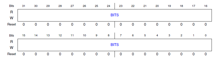

As an add-on to my above question, I see that MIMXRT1062.h has comments that seem to correlate various offsets into the OCOTP register space to addresses in the fusemap.  For example, if I wanted to see the Default FlexRAM bank partitioning as defined by the fusemap, then I could read OCOTP->MISC_CONF0 and decode bits [19:16].
When I go to the reference manual and look at the description of the MISC_CONF0  I see this description...
and that seems to be the extent of the "Diagram" for most of these registers.  So am I really supposed to refer to MIMXRT1062.h for the OCOTP documentation?
