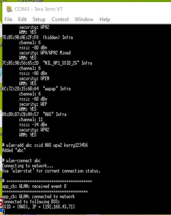

   Do you mean when you operate the LAB2 document, page 21, step 5 and step 6 can't connect to the network, right?
   If yes, you need to check your external AP point, you can use the cellphone to share the wifi hotpoint.
Take an example,my cellphone wifi hotpint is:
SSID: AWS
password: kerry123456
This is my test result:
THI

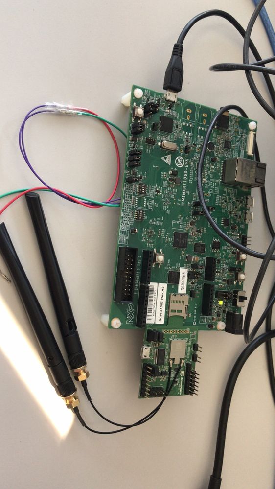

This is my hardware connection:
So, please check your external AP again, make sure it works.
Wish it helps you!
