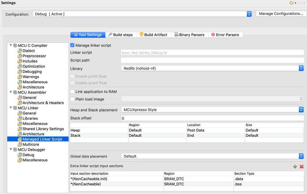

As far as first project is concerned (ram_iled_blinky.zip), please, start importing SDK EVK-MIMXRT1060 demo apps -> iled_blinky project.
Then, change C/C++ Build Settings -> Managed Linker Script -> select Link application to Ram.
Then create .bin by using Binary Utilities -> Create binary on .axf

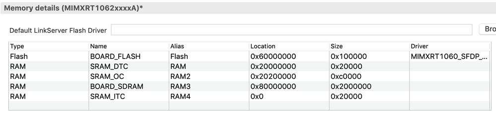

Regarding second project (boot_iled_blinky.zip) , start by importing SDK EVK-MIMXRT1060 demo apps -> iled_blinky project.
Change C/C++ Build Settings -> MCU Settings -> Flash Location 0x60000000 Size 0x100000 (instead of 0x800000 because we've reserved 0x60100000 to 0x60200000 for .bin image of the first project).
Now, create a header file and define two variables:
  • int value; // this variable is useful for creating an offset of blinky variable address
  • uint8_t blinky[19584]; // this is the content of the previous generated .bin file
Then, modify main for jumping to blinky's address.
If we don't set SET_OFFSET, then blinky's address is 0x20000000 and everything works fine (IS_RAM enabled).
If we set SET_OFFSET, then blinky's address is 0x20000004 and it doesn't work.
If we set IS_RAM, then blinky is populated by .bin defined array.
If we don't set IS_RAM, then blinky is populated from Flash (copy Flash to Ram).
Please, advice us if you need more details.

There're some suggestions for you.
1. Confirm the different image has been programmed to the related flash area.
2. Use the malloc() function to apply for the RAM area for store the slave application.
3. The SCB->VTOR also need to be updated.
TIC
14,048件の閲覧回数
DanielePagani
    Hi jeremyzhou,
thanks for your suggestions.
I confirm that now we can correctly run XIP and not XIP application by jumping to Flash Address and setting SCB->VTOR register.
    uint32_t address=(uint32_t)&blinky[0];
    SCB->VTOR = address; // it must be 256 aligned
    JumpApplication(*(uint32_t*)address, *(uint32_t*)(address+4));
As far as malloc is concerned, according to Re: Malloc failed in RT1060-EVK project CSI_RGB565, it seems that is better don't use it.
Then, according to "ARMv7-M Architecture Reference Manual" B3-13 and Re: Relocate verctor table, SCB->VTOR must be 256 bytes aligned, so, how can use malloc with custom alignment?
Flashloader demo application uses a custom Linker Script (MIMXRT1062_ram_flashloader.ld), so, it's totally different running standard application (XIP or not-XIP) than this type of application (run from RAM). For standard application, we've to jump to Flash Address. For applications like Flashloader, we've to jump to Ram Address. Is it correct?
BR,
Daniele

So, we're wondering if we've to set Memory Configuration to something different than default.
We've attached Managed Linker Script settings and MCU Settings.
