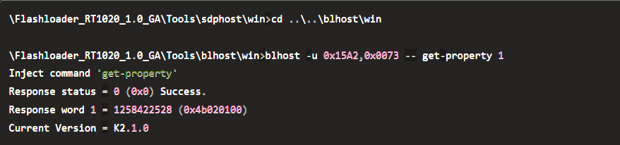

I've been using a MIMXRT1024-EVK board, and the information provided in this post mimxrt1024-EVK-flash-and-boot . I downloaded the SDK for MIMXRT1024-EVK and MCU Boot middleware. I noticed I have the execulate for the sdphost, but it's missing the executable for blhost (not found in any directory). I ended up finding a version of blhost from the Flashloader_RT1050_1.1 example. The version of blhost from the example is shown below:

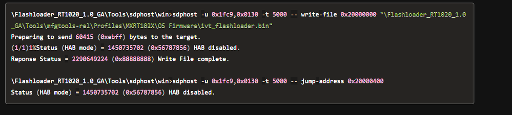

I follow the steps present in the post mimxrt1024-EVK-flash-and-boot  also setup my dip switches for serial download (SW8-3 and SW8-4). The exact commands from the post say to run these commands

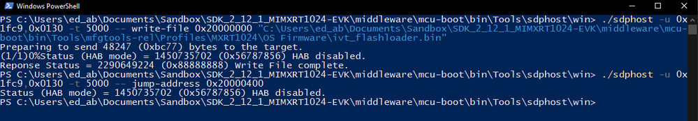

I get the following output from my powershell indicating I have been able to successfully program the ivt_flashloader.bin that came from the MIMXRT1024-EVK SDK builder using the sdphost.exe from the SDK Builder:

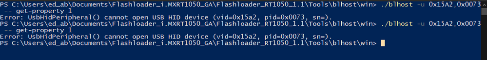

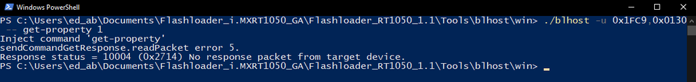

I had to run the blhost from the Flashloader_RT1050_1.1 example since it wasn't present in the MIMXRT1024 as explained earlier. The following is the error I get from blhost. I kept my SW8 dip switches for serial download, and did not reset the board:
It seems to time out when running the blhost command. I verified the vid and pid are from the NXP MIMXRT1024-EK board.
I guess my question is why can I not communicate with the flashloader???

The below command is wrong.
The ivt_flash loader.bin should be written to 0x20208000 instead of 0x20000000, further, the jump to 0x20208400 instead of 0x20000400.

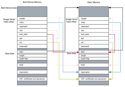

1) The screenshot is a snap t of the ivt_flash loader.bin, I can parse the IVT struct to find out the address of the application that should be resided.

1. the blhost tool from Flashloader_RT1050_1.1 package can be used for your RT1024 case, it is common tool.
2. Your issue has nothing to do with the blhost version
3. it is not flashloader issue, but blhost arg issue. blhost tool always use 0x15a2,0x0073 as usb id, please check you id setting in your command.

eablan
I attempted to use the 0x15a2,0x0073 vid and pid, but it does not work. Below is a screenshot of that vid and pid using the default you mentioned, and checked the windows device manager and 0x15a2,0x0073 does not show up as a vid and pid on the computer after running sdphost to program the ivt_flashloader.bin

1. Is the issue where in memory I am flashing the ivt_flashloader.bin? It's currently being written into DTCM.
2. Is it that the ivt_flashloader.bin is not getting flashed correctly by the sdphost tool? Is the jump address correct? This is the output:
3. I'm keeping the SW8 dip position for serial download the whole time, and not resetting power or resetting the micro. Is there a jumper I need to change around on the MIMXRT1024-EVK that I am missing?

jay_heng
You cannot load ivt_flashloader.bin to any dest address as you want, this bin should be loaded to where it is linked in project.
For your case, you should load it to 0x20208000
-- write-file 0x20208000 ivt_flashloader.bin
-- jump-address 0x20208400
