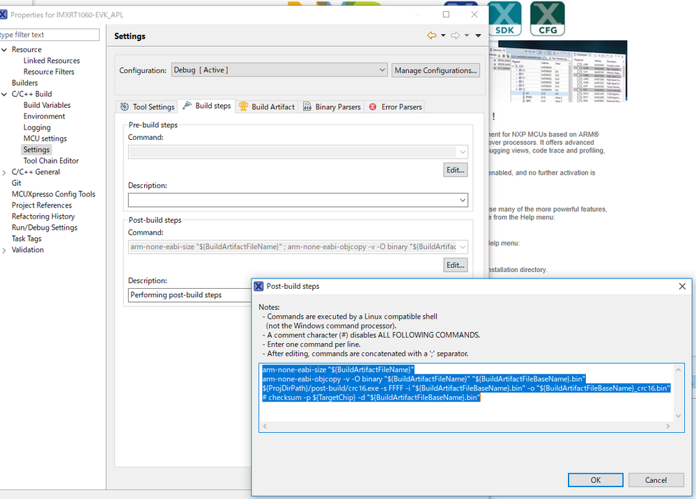

> 1. the binary can be created with objcopy, Right ? (the default compile to axf format)
Yes, I use Post-build steps asfollows. In defult setting, Line of arm-none-eabi-objcopy is comment outed, Please delete '#' and enable arm-none-eabi-objcopy.

Performing post-build steps
arm-none-eabi-size "IMXRT1060-EVK_APL.axf" ; arm-none-eabi-objcopy -v -O binary "IMXRT1060-EVK_APL.axf" "IMXRT1060-EVK_APL.bin" ; C:/workspace/IMXRT1060-EVK/IMXRT1060-EVK_APL/post-build/crc16.exe -s FFFF -i "IMXRT1060-EVK_APL.bin" -o "IMXRT1060-EVK_APL_crc16.bin" ; # checksum -p MIMXRT1062xxxxA -d "IMXRT1060-EVK_APL.bin"

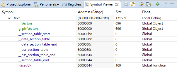

> 3. Is ResetISR  equals to DefDST_RAM_TOP+4 in your case ?
Yes. I have used g_pfnVectors. StackTop value and address of ResetISR are allocated as follows.

Please see your axf file by symbol Viewer. Is g_pfnVectors allocated in RAM_TOP(maybe 0x20000000) in your Project?

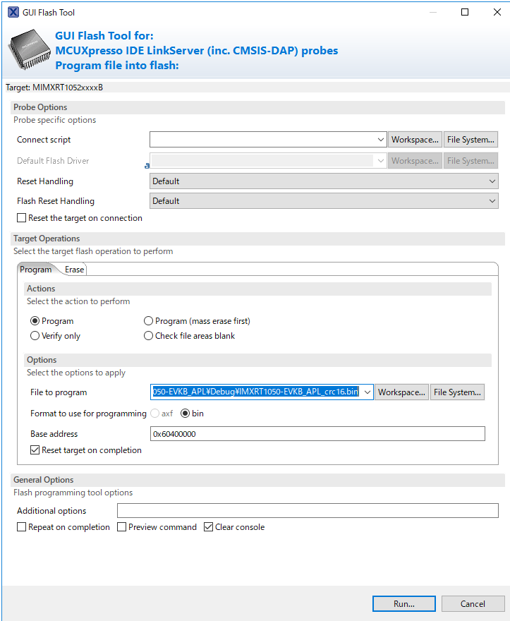

> 2. you said before that "binary image is written in specific area on ROM".
>    How did you do this ? A project is compiled into .axf format, how did you wrote it into flash ?
In my case, I make *.bin file by Post-build-action. And I used GUI Flash Tool to write binary image as follows.
(GUI Flash Tool is included in MCUXpresso IDE).
Base Address 0x60400000 is the specific area(DefROM_BIN_TOP).

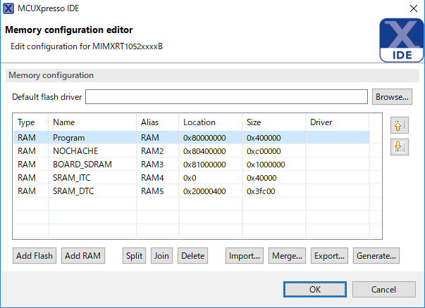

In my Project, Unlike the sample code, binary size is appended to the beginning of the binary image and CRC is added to the end.
StartEndContents
0x600000000x603FFFFFROM : BOOT Project
0x604000000x6040003ROM : Size of APL(uint32_t)
0x604000040x607FFFFFROM : APL Project(Binary Image with CRC)
0x800000000x803FFFFFRAM : APL Project(Area to actually run)

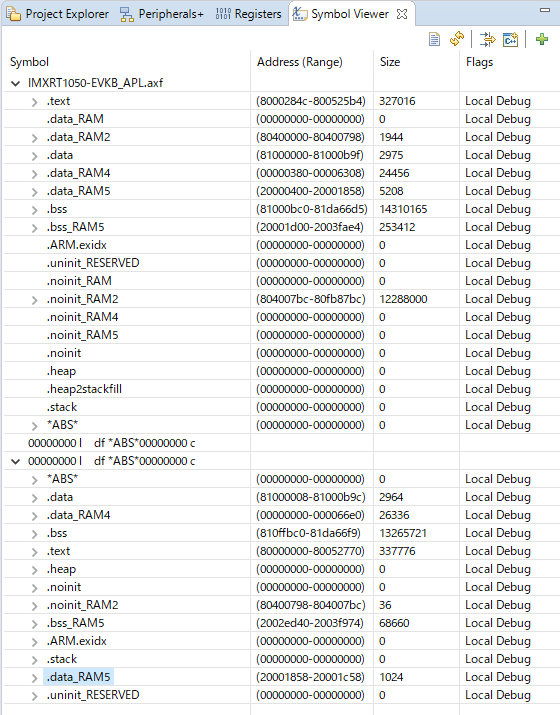

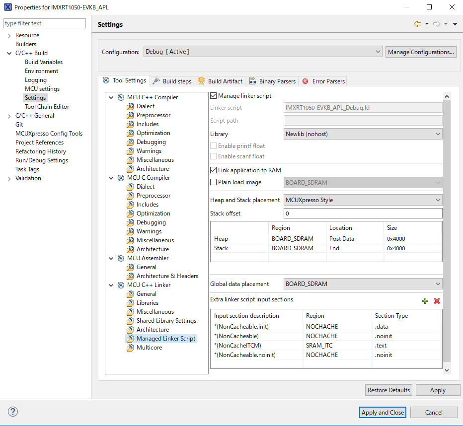

When executing a program in RAM, the TEXT section must first be located in the RAM. you nead to check "Link Application to RAM" as follows.
As a result, the Text section is placed in the first RAM area set in "Memory Configration Editor".
And the debugger writes the program directly to RAM.  You can check from the memory browser whether the program was written in RAM. Please check whether the program was placed at the intended address.
In the following example, the .text section is placed in "RAM" (0x80000000 -).
