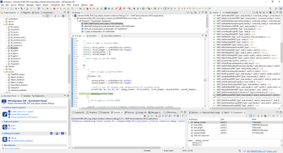

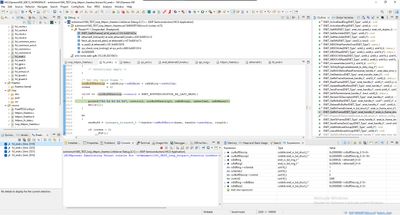

pjanco
1.
Yes it enter while loop second time with index == 1.
2.
I am not sure what you need.
I added tst_var and put break point to "Overflow problem assertion". Value of tst_var on breakpoint is 0.
See code below:

 And there are debug variables:
Peter.
21,639 Views
AbnerWang
Hi Peter,
Your provided code shows curBuffDescrip2=0x20000090, curBuffDescrip=base+genIdx=0x20000088.
1. I guess current BD LAST bit = 0, next BD LAST bit = 1. So curBuffDescrip++.
Firstly check whether (0U == (curBuffDescrip->control & ENET_BUFFDESCRIPTOR_RX_EMPTY_MASK)) and (0U == (curBuffDescrip->control & ENET_BUFFDESCRIPTOR_RX_LAST_MASK)) happen at the same time when function just enters. As I mentioned before, previously I think BD should be set LAST bit when EMPTY sets 1->0 by DMA when one frame one BD case as you are. But now I doubt this, so please help me confirm it. If this is the root cause, I need to wait the feedback from Soc design team.
Another strange thing is the second BD set LAST bit as 1, usually this occurs when one frame stores in two BDs. Every time driver receives frame from BDs, it will clear LAST bit. So I don't know why current BD and next BD's EMPTY bits = 1 but only second BD's LAST bit = 1. Can you confirm whether curBuffDescrip->buffer takes entire frame and curBuffDescrip->length is right. And check (nextBuffDescrip)->buffer/length value together.
2. If above test can't make a conclusion, it looks either stack overflow somewhere modifies the value of curBuffDescrip. Can you debug further to locate the specific code doing this? From raw code logic, I can't find the root cause.
Best Regards.
Abner

	if (0U == (curBuffDescrip->control & ENET_BUFFDESCRIPTOR_RX_EMPTY_MASK) && 0U == (curBuffDescrip->control & ENET_BUFFDESCRIPTOR_RX_LAST_MASK))
		condition++;
And at my error breakpoint, variable condition have value 1:
Peter.
21,555 Views
AbnerWang
Hi Peter,
Perfect! Can you provide the buffer/length content in current BD and next BD. I want to check what's frame data in BDs at this time. When this issue occurs, print or backup the 'curBuffDescrip->length' of data in curBuffDescrip->buffer and curBuffDescrip->length value, plus same content of nextBuffDescrip->buffer/length.
To get nextBuffDescrip is just moving the index:
rxBdRing->rxGenIdx = ENET_IncreaseIndex(rxBdRing->rxGenIdx, rxBdRing->rxRingLen);
nextBuffDescrip = rxBdRing->rxBdBase + rxBdRing->rxGenIdx;
Best Regards.
Abner

pjanco
there is my debug print screen with requested values:
I am also sending my whole testing project in attachment. My project is configured to use Hyperflash instead of Norflash. To use project on your side, I recommend to download "evkmimxrt1060_lwip_httpsrv_freertos" from SDK examples and then copy changed files from my project to your project.
Changed files are: "fsl_enet.c", "httpsrv_freertos.c", "httpsrv_fs_data.c"
And in file "lwip_httpsrv_freertos.c" I just changed configured IP address to fit my network.
To reproduce the problem, put breakpoint to "while(1);//STAY THERE", then open index web page on chrome web browser. Load some 40MB big file and press upload file:
Now just wait for the breakpoint.
There is no feedback of upload on the web page. I am using ping to monitoring if board is still alive.
Peter.
