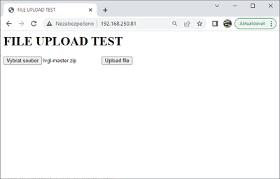

I have own board design based on EVK-MIMXRT1060. When transferring large data over TCP/IP in direction from my PC to IMXRT board, it very often ends in this assertion and then restart on watchdog.
LWIP_ASSERT("Buffer returned by ENET_GetRxFrame() doesn't match any RX buffer descriptor",((idx >= 0) && (idx < ENET_RXBUFF_NUM)));
I am currently using SDK 2.11.0 but I noticed that in changelog for SDK 2.13.0 is this bugfix:
port: Fixed copying of pbuf contents. Previous code was using an incorrect end
condition and could result in the overrun of the destination buffer if more packets were
on the queue.
It is possible that this can fix mine bug. But migration between SDK versions is so hard with NXP.
I prefer to stay with old SDK and just fix this bug.
Can you provide short bugfix of this overrun for SDK 2.11.0 ?

my project was based on "evkbmimxrt1060_lwip_httpssrv_mbedTLS_freertos" and I did not change low level enet configuration.
I can prepare testing project for you to reproduce the problem on MIMX board. Goal is to create long critical section and then send a lot of packets. Some days, I am not able to reproduce this problem and next day, it happed very often.

pjanco
there is my debug print screen with requested values:
I am also sending my whole testing project in attachment. My project is configured to use Hyperflash instead of Norflash. To use project on your side, I recommend to download "evkmimxrt1060_lwip_httpsrv_freertos" from SDK examples and then copy changed files from my project to your project.
Changed files are: "fsl_enet.c", "httpsrv_freertos.c", "httpsrv_fs_data.c"
And in file "lwip_httpsrv_freertos.c" I just changed configured IP address to fit my network.
To reproduce the problem, put breakpoint to "while(1);//STAY THERE", then open index web page on chrome web browser. Load some 40MB big file and press upload file:
Now just wait for the breakpoint.
There is no feedback of upload on the web page. I am using ping to monitoring if board is still alive.
Peter.
