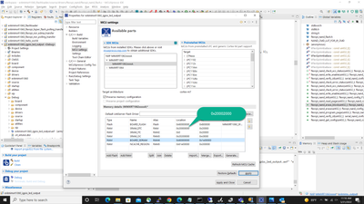

1) Please modify the address the below figure shows;
