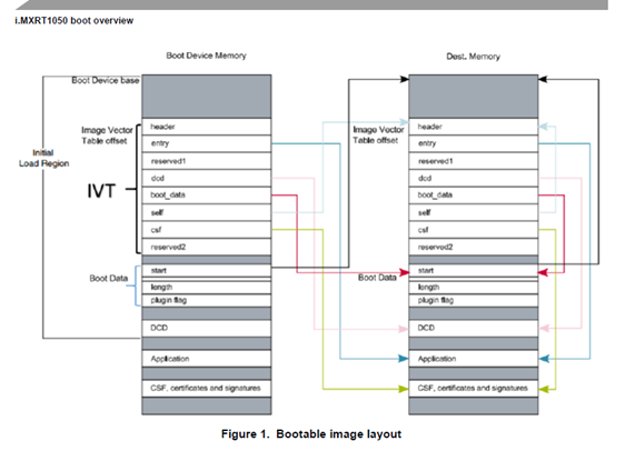

Bootable Image Structure:
The bootable image consists of:
  • FlexSPI Configuration Block (FCB)
  • Image Vector Table (IVT)
  • Boot Data
  • Device Configuration Data (DCD)
  • Program image
  • CSF, Certificates, and signatures (this stuff is optional and only comes with high-assurance boot
I’ll briefly explain each below:
The FCB will configure the settings of the FlexSPI communication. It will establish how many ports will be used, what clock speed to run the FlexSPI controller at, etc. This is the first thing that happens, as everything else is stored in Flash memory. In order to read anything else, the flash must first be configured.
The IVT is a table that tells the memory the addresses of where everything is stored.
Boot Data
The Boot Data contains pointers to the start address of the Memory.
The DCD contains configuration data to configure any peripherals.
Program image
The program image contains the code you write to go into the application.
These things are optional. They come with high-assurance boot sequence and will not be covered in this writeup.
Below is a rough table outlining these different parts of the boot image:

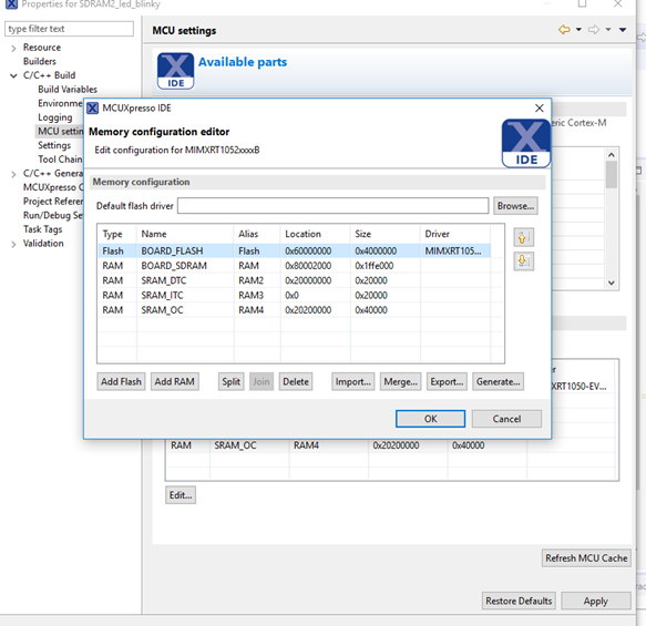

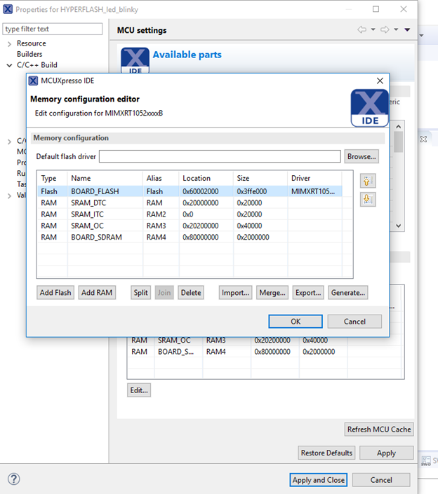

Begin by changing memory allocation in the memory configuration editor (edit project settings >> C/C++ Build >> MCU settings >>edit. It should look like the one below.

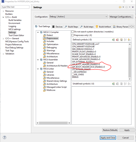

Then go to C/C++ Build >>settings > MCU C compiler > preprocessor and set the XIP_boot_header enable and and XIP_boot_header_DCD_enable both to 0 if you have a dcd.bin file to use. Otherwise set these fields to 1.
Hit apply and close.

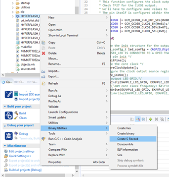

Go to the debug portion and click on binary utilities, then generate an s-record (.s19) file from MCUXpresso.

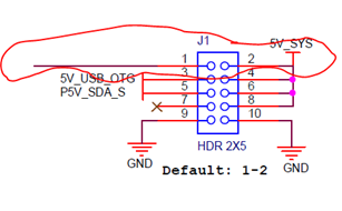

In order to do this, the board SW7 must be set to OFF-ON-OFF-ON, and switch the jumper from J1  (5-6) to J1 (3-4). Connect the USB cable to J9 to power the board. Then connect the board to your computer and run the Mfg tool. Click start and the image will be uploaded.
Copy the boot_image.sb file that we created in the last step. Move it to the directory Tools > mfgtools-rel > Profiles > MXRT105X > OS Firmware, and drop it in here.
Next, set SW7 on the board to OFF-ON-OFF-ON, and switch the jumper at the bottom to power the board. Then connect the USB cable to J9. This will allow you to program the board.

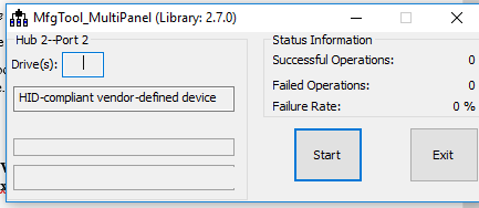

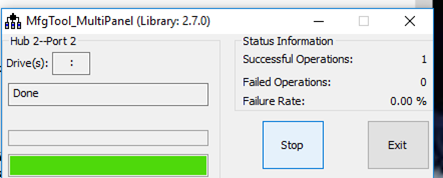

Go back to the folder mfgtools-rel and Open the Mfg Tool. It should say HID- compliant vendor-defined device. Otherwise double check SW7 and the power pin at the bottom right.
Click start and if successful it should look like:
Please note that this success only means that it was able to upload the bootable image to the board. This usually works well. However, if you find later that the board doesn’t do what it’s supposed to, then there might be a problem in the other steps of the processor. Check to make sure you used the right linker file, and that the settings in MCUXpresso are configured correctly.
Press stop and exit
Remember to switch the pin headers back, so the board can boot normally. J1 (5-6) and SW7 to OFF-ON -ON -OFF to boot from Hyperflash.

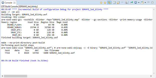

Bootable Image Generation – SDRAM
The guide is based off this link: https://community.nxp.com/docs/DOC-340655 . Download the files provided there, and unzip. Everything is good except the first step of that pdf document is a little unclear.
MCUXpresso Configurations and output:
Begin by changing memory allocation in the memory configuration editor of the MCU Settings part of MCUXpresso. It should look like the one below.
Then go to settings > MCU C compiler > preprocessor and set the XIP_boot_header enable and and XIP_boot_header_DCD_enable both to 0

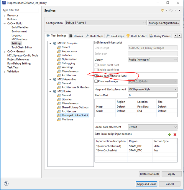

Go to C/C++ Build >> Settings >> MCU Linker >> Manage linker script, and check the box Link application to RAM.
Click build to re-build the project.
You can check the console to verify the correct allocations of memory:
Copy this .s19 file.

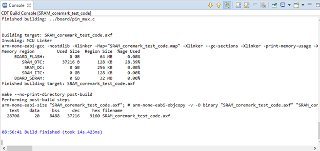

Bootable Image Generation – SRAM
This one was a little trickier as there was no appnote, but not too bad.
Begin by changing memory allocation in the memory configuration editor of the MCU Settings part of MCUXpresso. It should look like the one below. We are linking to copy everything to dtc RAM
You can verify that application is linked to SRAM in the console:

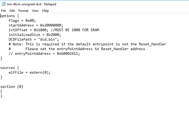

This step is specific to dtcm ram: Go to Tools >>bd_file >> imx10xx, and open up the imx-dtcm-unsigned-dcd.bd file and change the ivtOffset address to 0x1000. 0x400 is the default for SDCARD booting.
To be clear, the bd file should look as below:
