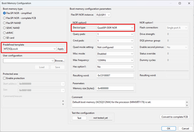

I have a big problem. I'm trying to configure the flexspi_nor_config_t qspiflash_config, using the  i.MXRT1060, with a Serial Nor Flash : MT25QL512ABB1EW9.
I need to work in DDR an QSPI mode..
After an hard research, I found a lot of information but not always clear. I found, i.e. this post:
https://community.nxp.com/t5/i-MX-Processors-Knowledge-Base/i-MX8DXL-FlexSPI-configuration-parameter...

Hi @Luke1982,
I strongly recommend you try using Secure Provisioning Tool instead, as the proper configuration can be done much more easily on the "Boot Memory Configuration" window:
BR,
Edwin.
