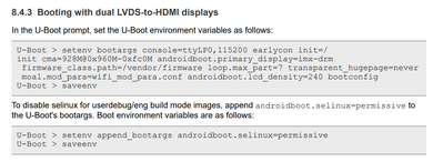

The hdmi connector on my mek device fell of, now I want to use the lvds, using the adapter that came in the imx8qm-mek demo box. I have no ideea how to get it to work.
I flashed the sd card via uuu, parameter hdmi, the NXP logo appears on my monitor ( connected via hdmi adapter to lvds), and then nothing, once linux starts display goes to sleep. I have tried the lvds1 dtbs :
vbmeta-imx8qm-lvds1-panel.img also, same result ( had to modify the script a bit to accept it )
Here is the flash log:
PS C:\work\nxp\android-13.0.0_2.2.0_image_8qmek> .\uuu_imx_android_flash.bat -f imx8qm -a -e -t sd_all -u dual -d hdmi

Hi @Ahelion
Please refer the Android Quick Start Guide:https://www.nxp.com.cn/docs/en/quick-reference-guide/ANDROID_QUICK_START_GUIDE.pdf
To test the LVDS-to-HDMI display, use the i.MX mini SAS cable to connect the LVDS-to-HDMI adapter to the "LVDS0/LVDS1" port.
To test LVDS-to-HDMI/MIPI-DSI-to-HDMI display, it does not need to use the -d option. Four display ports of LVDS0_CH0, LVDS1_CH0, MIPI_DSI0, and MIPI_DSI1 can be used for display individually or together.
