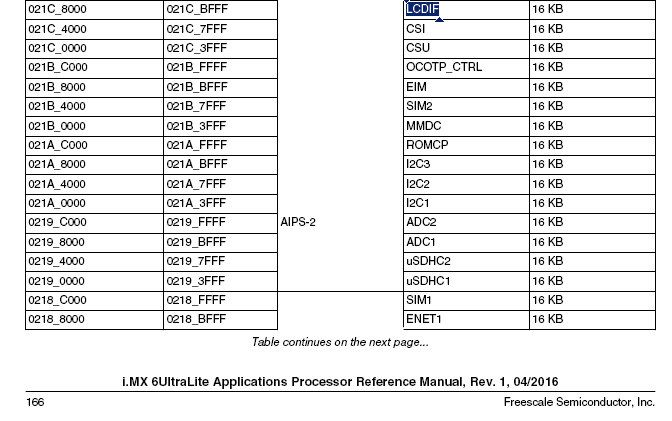

I am using imx6ulevk eavaluation kit. I am using yocto following L4.9.88_2.0.0 user guide.
My evaluation kit has lcd. I want to understand its initialization routine.
Could someone please help me with reg address in device tree
lcdif: lcdif@21c8000 {
compatible = "fsl,imx6ul-lcdif", "fsl,imx28-lcdif";
reg = <0x021c8000 0x4000>;
interrupts = <GIC_SPI 5 IRQ_TYPE_LEVEL_HIGH>;
clocks = <&clks IMX6UL_CLK_LCDIF_PIX>,
<&clks IMX6UL_CLK_LCDIF_APB>,
<&clks IMX6UL_CLK_DUMMY>;
clock-names = "pix", "axi", "disp_axi";
status = "disabled";
where is the reg address 0x021c8000  defined ? In reference manual or user guide.
How can I know interrupts = <GIC_SPI 5 IRQ_TYPE_LEVEL_HIGH> is defined for lcd?

one can look at uboot/board/freescale/mx6ul_14x14_evk/mx6ul_14x14_evk.c
mx6ul_14x14_evk.c\mx6ul_14x14_evk\freescale\board - uboot-imx - i.MX U-Boot
in linux sect.6.3.4 ELCDIF Frame Buffer attached Linux Manual.
Right, reg address 0x021c8000 and interrupts are defined in Reference Manual.
igor

Thank you for the reply. I checked in the above pdf and also IMX6ULRM pdf, I didnt find any address for LCD. If you know can you please specify line number.

Thank you igorpadykov‌, my bad. I was directly trying to search that address.
