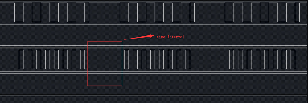

Hello!
   I am using imx6ul
   The kernel version is linux4.1.15
   I configured the device tree and kernel and tested it with Documentation/spi/spidev_test.c
   However, I set up an 8-bit transfer. After the clock has finished transmitting the 8-bit byte, there will be a time interval and then the clock will be sent. As shown below, I should modify it there to modify the size of the interval.

I am afraid it is not possible to decrease time interval, as it is caused
by processor internal bus delays. For improving throughput one can increase
BURST_LENGTH parameter in ECSPIx_CONREG register or try with/or without
sdma:
                ecspi1: ecspi@02008000 {..
                    dmas = <&sdma 3 7 1>, <&sdma 4 7 2>;
                    dma-names = "rx", "tx";
imx6ul.dtsi\dts\boot\arm\arch - linux-imx - i.MX Linux kernel
igor

   I use dma transfer or pio transfer, it will have the above problem

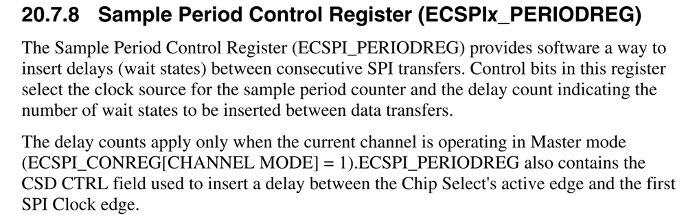

   How should ECSPIx_CONREG register be configured?
   I saw it in IMX6ULRM
   Is it possible to configure this register?
      How to configure if I can. I didn't find the location of this register in the kernel.
Thank you

linux driver does not use it, so it is in reset state, so seems there is no
way to decrease it more.
igor

I had a same problem in imx6qdl and I have to reduce the interval of the spi clock.(actually, I have to get no interval in spi clock)
I am wondering the way can modify the interval of the spi clock.
Is the interval time related in Clock Controller Module?

   Can I modify the interval of the spi clock? Or is the interval time cpu design can not be modified?
