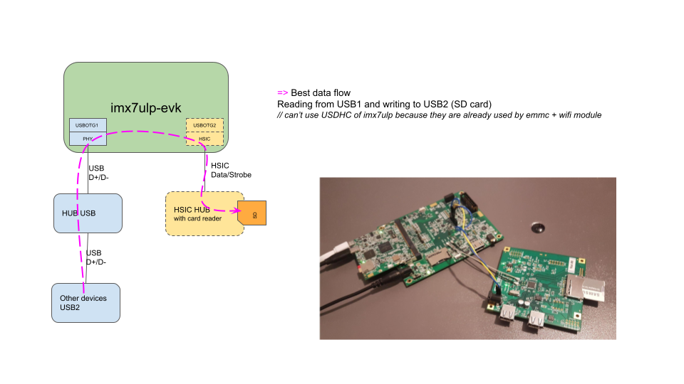

2) About your response, and to be sure I well understood, you are saying that this king of configuration is not possible :
=> Reading from a device plugged on USB1HOST and writing to a device plugged on USB2HOST at the same time ?
A simple diagram to make sure that my question is clear :

3,107件の閲覧回数
weidong_sun
Hello @guillaume-enlaps ,
We have ever spent much more time in debugging HSIC on i.MX7ULP for a customer from India , who also used HSIC EVK board. we also borrowed HSIC EVK board from microchip for the debugging purpose.
In the end, we found USB OTG1 clock would lose as soon as HSIC(USB OTG2) was enabled, which means USB OTG1 can't be used at the time, so any way, whether it is device or host , it can't work.
So for your application, you had better choose a HSIC HUB with 4 ports, which can ensure USB HOST Ports is enough for your application.
