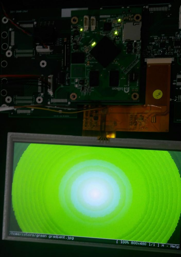

Hi. I'm using an imx7d based custom bord. Everything is fine but bad screen appearance while showing color gradients. My LCD have RGB 24-bit parallel connection. I'm not sure the problem is related imx7Dual's graphics processing skills or my kernel configuration. what do you think about this problem and can you help me to solve the problem?
PS: There is not any problem with solid colors and I can play videos without stuttering. Touchscreen is ok too..

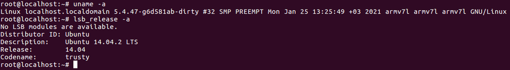

Here are my kernel and distro versions;
Screenshot from 2021-01-25 13-46-07.pngScreenshot from 2021-01-25 13-46-07.png

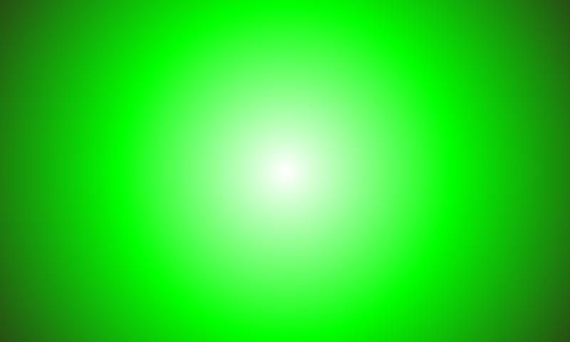

This is an example gradient jpg file on PC; green_gradient.jpggreen_gradient.jpg
and what I see on my LCD;
(command is fbi -T 1 /home/colors/green_gradient.jpg )
WhatsApp Image 2021-01-25 at 13.41.32.jpegWhatsApp Image 2021-01-25 at 13.41.32.jpeg

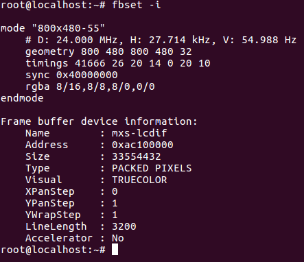

fbset -i output;
Screenshot from 2021-01-25 13-43-50.pngScreenshot from 2021-01-25 13-43-50.png

3,516件の閲覧回数
Ahmet_Cihan_AKINCA
This problem is solved, thank you for your help joanxie. I ordered a new, different brand LCD and checked everything again. I found that 3-bit green and 1-bit blue line is corrupted on PCB board. So, I was seeing colors in a low bit band. What a luck! By the way, I learned the LCD kernel code very well on this occasion.
5 返答(返信)
3,517件の閲覧回数
Ahmet_Cihan_AKINCA
3,577件の閲覧回数
Ahmet_Cihan_AKINCA
Hi Joanxie. My display is Satoz, SAT070CP40. I checked timings over and over, I tried lots of different configurations. As far as I can detect, the problem is caused by the LCD clock polarity. I'm trying to find the related low-level function in kernel 5.4.47. Thank you.
3,557件の閲覧回数
joanxie
you can refer to the document as below: "https://community.nxp.com/t5/i-MX-Processors-Knowledge-Base/iMX6QD-How-to-Add-24-bit-LVDS-Support-in..." focus on the
8. sync: Since the timing chart tells us that hsync/vsync are active low, so we don’t need to set FB_SYNC_HOR_HIGH_ACT or
       FB_SYNC_VERT_HIGH_ACT. Moreover, clock polarity and data polarity are invalid, so we set sync to be zero
3,535件の閲覧回数
Ahmet_Cihan_AKINCA
I accessed LCDIF registers and changed VSYNC, HSYNC and DOTCLK polarities, nothing changed. I used "writel" function in mxsfb.c file for these register operations. Perhaps, I'm in a wrong way and this wave-like gradient problem is not related LCD driver. Do you recommend anything else? I'm suspicious about GPU or Pixel Pipeline.
3,604件の閲覧回数
joanxie
what display do you use? pls check if your dts file settings correct according to your display data sheet
