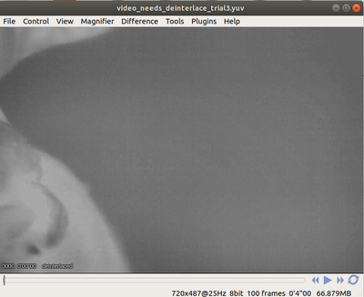

abeeshmp_dct
Hi igor,
Thanks for the reply, I refered the same patch only, But I am getting vide as shown in below figure.
Note : The actual video file is attached for your reference
YUV image getting from v4l2 driver
If I deinterlace it using an external application( I used Vooya player in Linux PC), we will get actual frame as shown below,
after deitneralcing using an exrenal application
Please have you comment on this issue.
I have put asked 3 questions in first query, out of that first two are related to this, and last one is related to the line skip option, Please answer those questions. If question is not clear, please let me know.

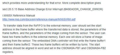

abeeshmp_dct
Hi Igor,
I checked the link https://community.nxp.com/t5/i-MX-Processors/Fixing-base-address-switching-Change-Err-which-occurs-r...
But, there it explains about the Base adress switching error, I didn't find any answers for the necessity of base address switch enable for interlaced video , and also that discussoin is about csi-mipi. In my case, it is 8 bit parallel video.
Could you please help me to solve the issue I mentioned in last answer ( about deinterlacing)?
4,597 Views
igorpadykov
in interlaced video one buffer is used for even data, another for odd.
Discussion is about CSI module which is similar to i.MX6ULL, i.MX6SX.
igor

abeeshmp_dct
Hi Igor,
As per the driver, we are giving two frame buffer's address to BUF1 and BUF2 base address registers and once we get the dma completion interrupt, then check for he BUF1 and BUF2 ineterrupt seperately and changes the corresponding base address registers accordingly,
So the DMA completion interrupt comes when we get the odd and even field contents into the frame buffer. And deitnerlacing is enabled and its stride is set from the driver for interlaced mode, I guess it is for the weaving method of data filling by the DMA for interacled mode.
And the critical thing is we are getting proper video with PAL format, the issue is with the NTSC video and from analysis,  I guess it is due to some miss in configuratoin..
Did you have any information of testing NTSC video capture using the imx6ull CSI module ?
4,572 Views
