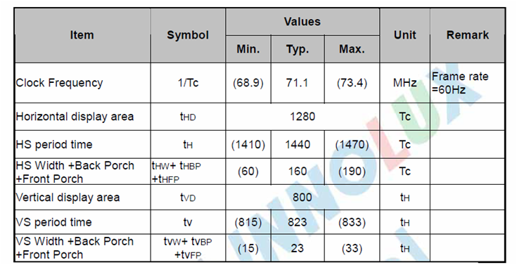

   Let’s take a look at the timing description quoted from a real 1280x800@60 24bit LVDS panel spec:

   What we need to do is to set every field of struct fb_videomode correctly according to the timing description of LVDS display panel’s spec:
    1. name: we can set it to ‘LDB-WXGA’.
   2. refresh: though it’s optional, we can set it to typical value, that is, 60(60Hz refresh rate).
   3. xres: the active width, that is, 1280.
   4. yres: the active height, that is, 800.
   5. pixclock: calculate with this formula – pixclock=(10^12)/clk_freq. Here, typically, for this example, pixclock=(10^12)/71100000=14065.

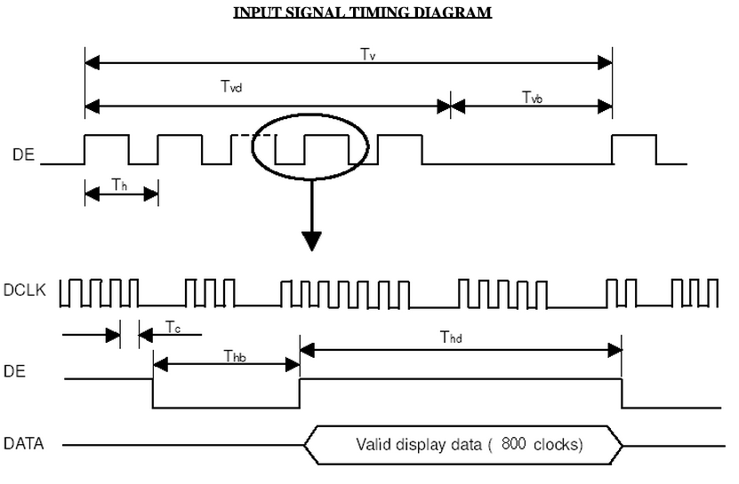

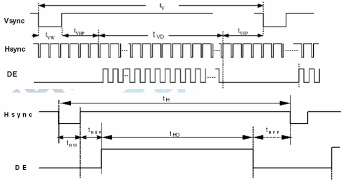

   6. left_margin/right_margin/hsync_len:
       They are the same to HS Back Porch(HBP)/HS Front Porch(HFP)/HS Width(HW) in the spec. Since the spec only tells us that typically
       HBP+HFP+HW=160. We may set left_margin=40, right_margin=40, hsync_len=80.
   7. upper_margin/lower_margin/vsync_len:
       Similar to horizontal timing, the vertical ones can be set to upper_margin=10, lower_margin=3, vsync_len=10.
   8. sync: Since the timing chart tells us that hsync/vsync are active low, so we don’t need to set FB_SYNC_HOR_HIGH_ACT or
       FB_SYNC_VERT_HIGH_ACT. Moreover, clock polarity and data polarity are invalid, so we set sync to be zero here.
   9. vmode: this is a progressive video mode, so set vmode to FB_VMODE_NONINTERLACED.
   10. flag: the video mode is provided by driver, so set flag to FB_MODE_IS_DETAILED.

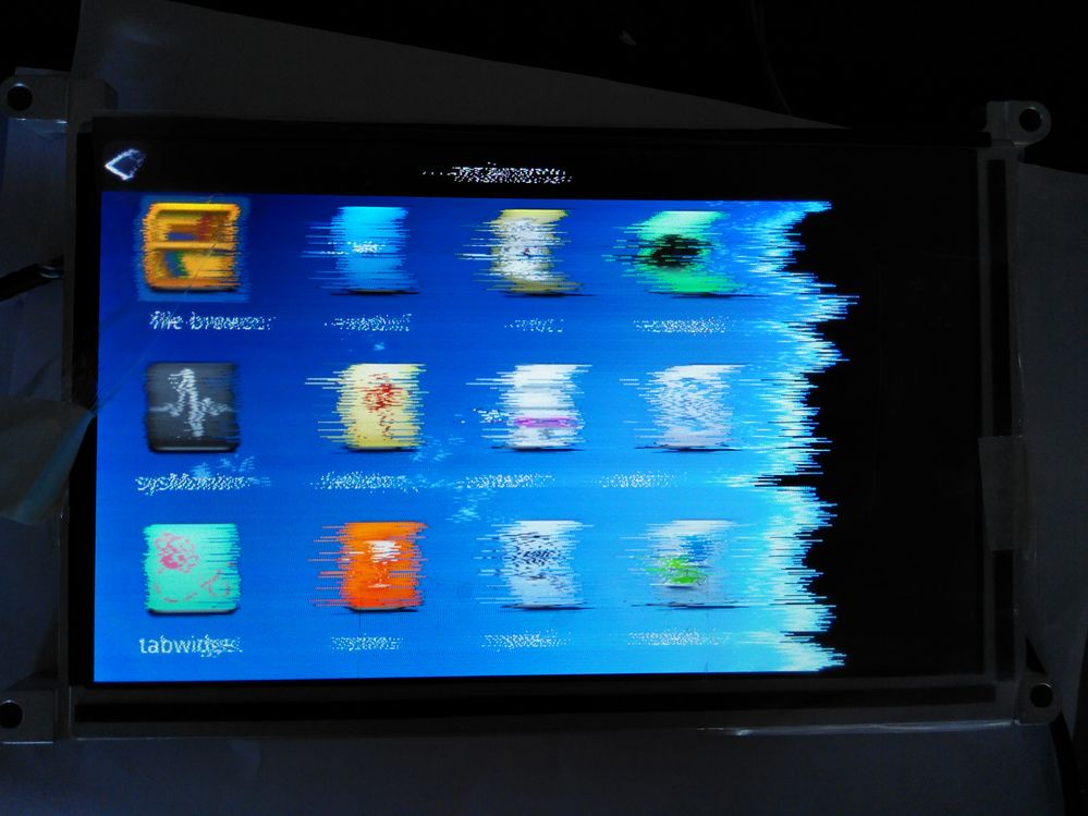

Thank you for the tutorial. But as i see, it is not applicable in Android Lollipop release, because the "ldb.c" is different.

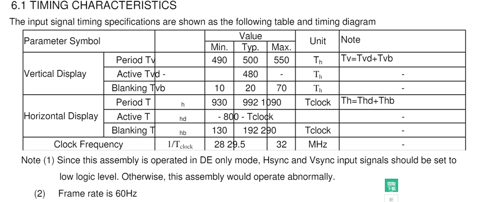

In my case the timings are fine. I have a LVDS panel that does not support EDID. I just want to change the default resolution from 1024x768 to 1024x600. My lvds panel works fine but the bottom stays outside of the panel. How can i fix this in Android Lollipop?

I have found the problem,it seems pixclock can only be set to up 40MHz,lower then 40MHz it's always output 40MHz,and my lcd can only works in 27MHz to 32Mhz
