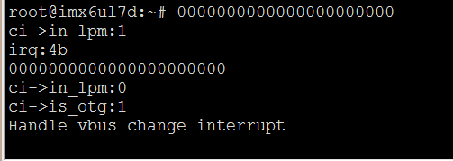

i saw the source .and add same debug infromation:
kernel-source\drivers\usb\chipidea\core.c
static irqreturn_t ci_irq(int irq, void *data)
  printk("0000000000000000000000\n");
  struct ci_hdrc *ci = data;
  irqreturn_t ret = IRQ_NONE;
  u32 otgsc = 0;
  printk("ci->in_lpm:%x\n",ci->in_lpm);
  if (ci->in_lpm) {
  printk("irq:%x\n",irq);
  disable_irq_nosync(irq);
  ci->wakeup_int = true;
  pm_runtime_get(ci->dev);
  return IRQ_HANDLED;
printk("ci->is_otg:%x\n",ci->is_otg);
  if (ci->is_otg) {
  otgsc = hw_read_otgsc(ci, ~0);
  if (ci_otg_is_fsm_mode(ci)) {
  ret = ci_otg_fsm_irq(ci);
  if (ret == IRQ_HANDLED)
  return ret;
  * Handle id change interrupt, it indicates device/host function
  * switch.
  if (ci->is_otg && (otgsc & OTGSC_IDIE) && (otgsc & OTGSC_IDIS)) {
  printk("Handle id change interrupt\n");
  ci->id_event = true;
  /* Clear ID change irq status */
  hw_write_otgsc(ci, OTGSC_IDIS, OTGSC_IDIS);
  ci_otg_queue_work(ci);
  return IRQ_HANDLED;
  * Handle vbus change interrupt, it indicates device connection
  * and disconnection events.
  if (ci->is_otg && (otgsc & OTGSC_BSVIE) && (otgsc & OTGSC_BSVIS)) {
printk("Handle vbus change interrupt\n");
  ci->vbus_glitch_check_event = true;
  /* Clear BSV irq */
  hw_write_otgsc(ci, OTGSC_BSVIS, OTGSC_BSVIS);
  return IRQ_HANDLED;
  /* Handle device/host interrupt */
  if (ci->role != CI_ROLE_END){
  printk("Handle device/host interrupt\n");
  ret = ci_role(ci)->irq(ci);
  return ret;
when i connect the pc :
first irq:change the low power mode.
but i can't understand the second time,why the ci->is_otg is 1?
my   dr_mode = "peripheral";
i know   ret = ci_role(ci)->irq(ci); is enable the irq for peripheral
source in: static irqreturn_t udc_irq(struct ci_hdrc *ci)  //kernel-source\drivers\usb\chipidea\udc.c
but it didn't happend.
