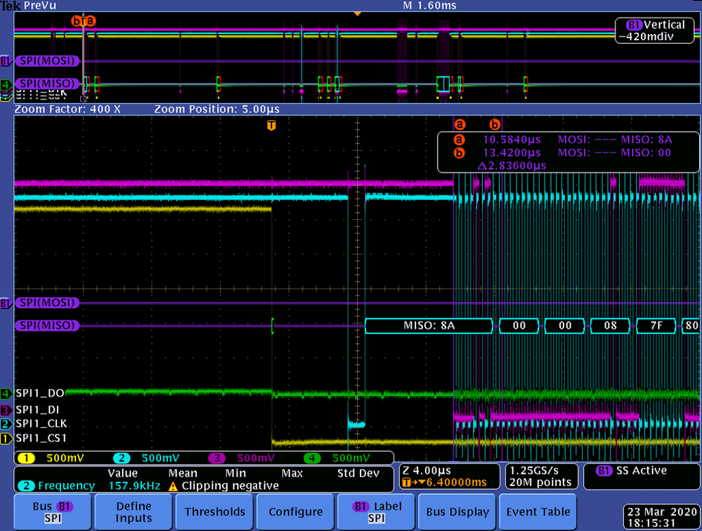

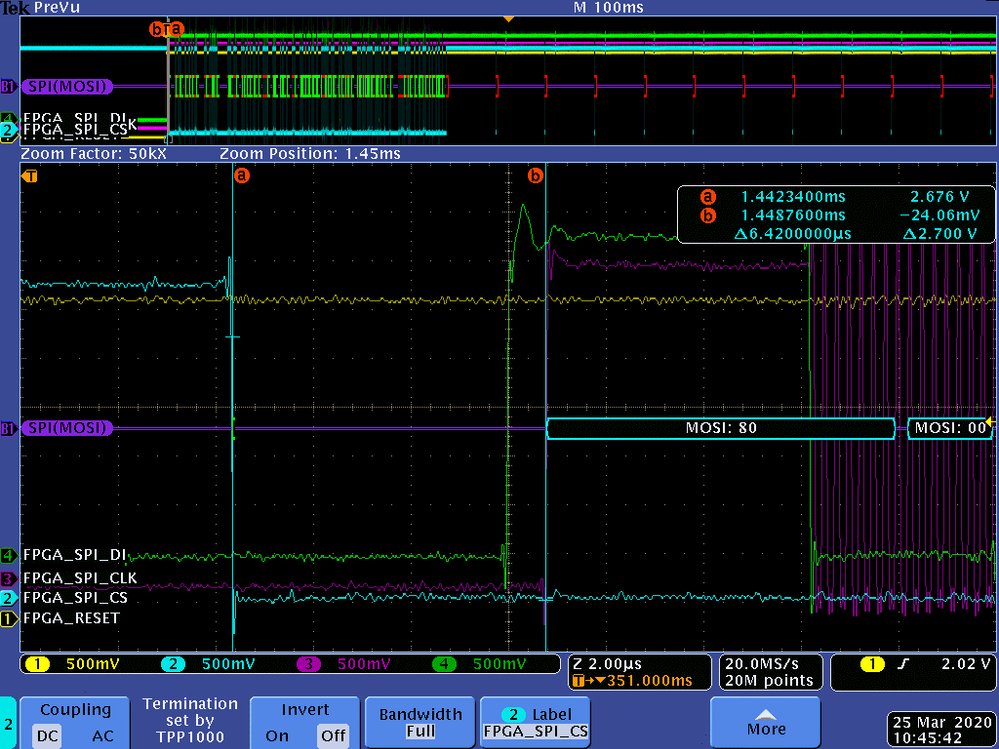

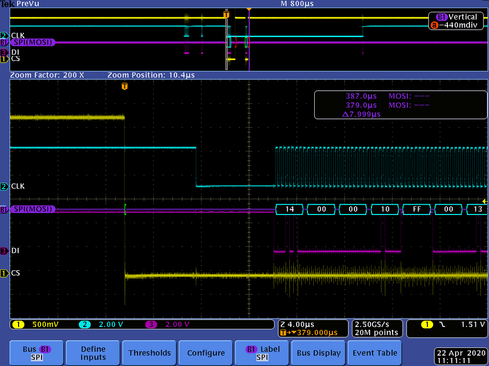

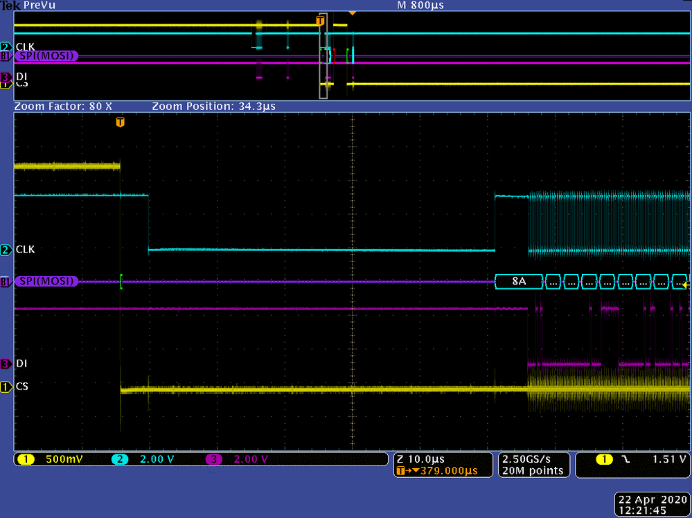

At the first packet of SPI communication,  SPI_CLK become High↑  after CS becomes Low ↓.
That's why the MSB bit always becomes "1".
Send data "14 00 00 10 FF" -> 0b1 + 0x14 + 0x00 + ... -> Receive data "8A 00 00 08 7F"
With another CS device , we can see same phenomenon for the first packet.
Send data "00 00 xx" -> 0b1 + 0x00 + 0x00 -> Receive data "80 00 xx"

Hi igorpadykov,
We found that this issue happen with SPI Mode3.
If I changed the setting from Mode3 to Mode0, CLK and data are no problem.

Anonymous
Deactivated User
Hi igor,
Without dma doesn't work, however, we can see that the wrong timing issue disappear by adding following 3 lines.
u32 sclk_val = 15;
writel(MX51_ECSPI_CTRL_ENABLE | MX51_ECSPI_CTRL_MODE_MASK, spi_imx->base + MX51_ECSPI_CTRL);
writel(sclk_val << 20 | sclk_val << 4, spi_imx->base + MX51_ECSPI_CONFIG);
This will be  a temporary solution for us.
