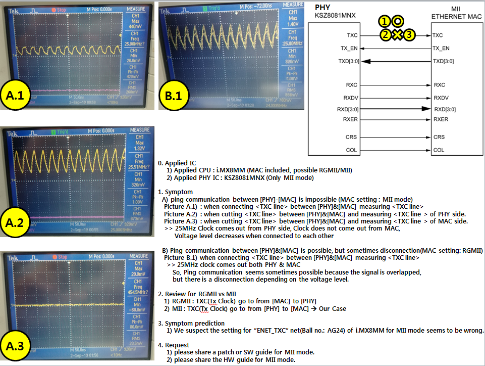

Please see the attached file for detail Picture : Ethernet MII mode issue on i.MX8MM_wKSZ8081MNX_20190904.pptxpastedImage_2.png
* Applied IC
    1) Applied CPU : i.MX8MM (MAC included, possible RGMII/MII)
    2) Applied PHY IC : KSZ8081MNX (Only MII mode)
1. Symptom
    A) ping communication between [PHY]-[MAC] is impossible (MAC setting : MII mode)
   Picture A.1) : when connecting <TXC line> between [PHY]&[MAC] measuring <TXC line>
   Picture A.2) : when cutting <TXC line> between [PHY]&[MAC] and measuring <TXC line > of PHY side.
   Picture A.3) : when cutting <TXC line> between [PHY]&[MAC] and measuring <TXC line > of MAC side.
   >> 25MHz Clock comes out from PHY side, Clock does not come out from MAC,
        Voltage level decreases when connected to each other
 B) Ping communication between [PHY]&[MAC] is possible, but sometimes disconnection(MAC setting: RGMII)
  Picture B.1) when connecting <TXC line> between [PHY]&[MAC] measuring <TXC line>
    >> 25MHz clock comes outboth PHY & MAC
       So, Ping communication seems sometimes possible because the signal is overlapped,
       but there is a disconnection depending on the voltage level.
2. Review for RGMII vs MII
   1) RGMII : TXC(TxClock) go to from [MAC] to [PHY]
   2) MII : TXC(TxClock) go to from [PHY] to [MAC] > Our Case
3. Symptom prediction
    1) We suspect the setting forENET_TXC“ net(Ball no.: AG24) of i.MX8MM for MII modeseems to be wrong.
4. Request
    1) please sharea patch or SW guide for MII mode.
    2) please share the HW guide for MII mode.

ken1
I''m  Ken Lee
 who posted above question for  "Ethernet MII mode issue on i.MX8MM (Applied PHY IC : KSZ8081MNX)"
I'm posting additional SW review like below.
1. Review : SW Changes for [RGMII (default) to MII mode]
  * Operating Environment: u-boot Status (not Kernel Status)
  1) To Change Parameter in “imx8mm_evk.h”
      >Before : #define CONFIG_FEC_XCV_TYPE             RGMII
      > After :  #define CONFIG_FEC_XCV_TYPE             MII100
  2) To Check “register setting value change.
       (Related Register map & SW code like below)
      > Before
          (1) FEC_RCNTRL_FCE  1
          (2) FEC_RCNTRL_MII_MODE  1
          (3) FEC_RCNTRL_RGMII    1
      > After
          (3) FEC_RCNTRL_RGMII     0
2. Request
    1) Please share if additionally Register settings  or additional works are required for the use of MII mode.
