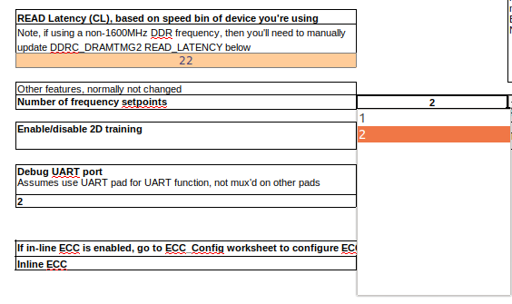

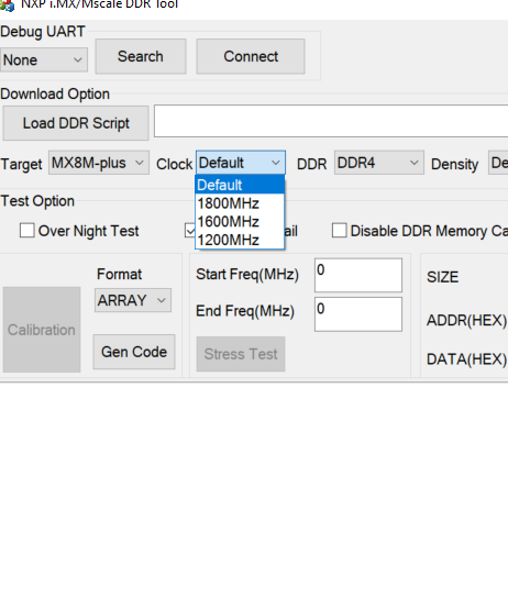

I tried to modify the RPA by changing number of frequency setpoints from 2 to 1 :
But MSCALE_DDR_Tool denied to run the stress test :
I then changed the Clock to specific value of my DDR4 (1600) instead of Default
but the ddr4_timing.c is the same as before (i.e 1336 still appeared).
Not sure how to remove that 1336 data rate out of the ddr4_timing.c.
K
5,407 Views
khang_letruong
Senior Contributor III
HI @Rita_Wang ,
I resolved the issue by being able to select 1 for Number of frequency setpoints
If I kept Number of frequency setpoints as 2, I think it would also work of I modified FREQ1 setpoints Clock Cycle Freq (MHz) from 668 to 533 for having data rate 1066 as the case of other references (including iMX8MP-EVK with DDR4) but I haven't tested yet.
