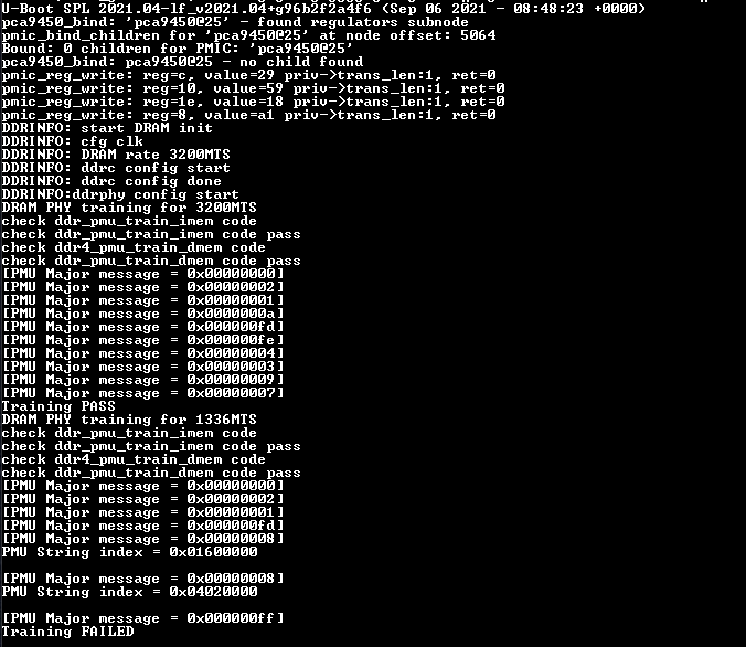

Hi @Rita_Wang ,
I was able to go a little bit further : not being stuck anymore but training reported FAILED for rate = 1336MTS :
What could be the issue, please ?
K

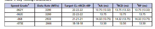

Precisely, our DDR4 is MT40A512M16LY-062:E and it has data rate 3200 in the below table :
So naturally the training is passed at that speed but not others. Do you think so? If yes, how to "by-pass" other training speeds, please?

khang_letruong
Senior Contributor III
Relate to training rate 1336, I found that it appears in the end of our generated ddr4_timing.c :

I tried to modify the RPA by changing number of frequency setpoints from 2 to 1 :
But MSCALE_DDR_Tool denied to run the stress test :
I then changed the Clock to specific value of my DDR4 (1600) instead of Default
but the ddr4_timing.c is the same as before (i.e 1336 still appeared).
Not sure how to remove that 1336 data rate out of the ddr4_timing.c.
K

HI @Rita_Wang ,
I resolved the issue by being able to select 1 for Number of frequency setpoints
If I kept Number of frequency setpoints as 2, I think it would also work of I modified FREQ1 setpoints Clock Cycle Freq (MHz) from 668 to 533 for having data rate 1066 as the case of other references (including iMX8MP-EVK with DDR4) but I haven't tested yet.
