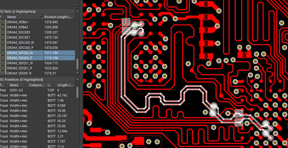

Hi all,
the DDR3 layout detail in iMX6UL design guide is not clear for me
so I read the IMX6UL 14x14 EVK board file LAY-28617_C2.brd
following table is the DDR3 trace length I extract from Altium
DRAM_SDCLK0_N1474.547

most of the signals trace length is reasonable
but the SDQS0_P/SDQS0_N is a question ,why they are traced about ~1110 mil?
should they trace to ~1000 mil around?
and following picture is SDQS0_P/SDQS0_N trace, they can be traced to ~1000,
why 1110 mil?
1,287 Views
Yuri
@mengxp
  according to Table 22 (DDR3 routing by byte group) of Hardware Development Guide
signals in byte group should match the signals of each byte group ± 25 mils.
Match the differential signals of DQS ± 10 mils
https://www.nxp.com/webapp/Download?colCode=IMX6ULHDG
  Looks like no problem in Your case.
Yuri.

and these is my DDR3 trace length, is this ok?
