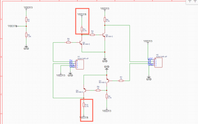

Hello, technician friend:
I referred to the original design and set the voltage of NVCC_UART to 1.8V, but I found that the specification described that it could support 1.8V or 3.3V voltage mode, but I failed to find out how to configure it to work in 1.8V or 3.3V mode, and whether the configuration is realized by hardware or software, I hope you can give me advice.  thank you  .
Currently, I have encountered a very strange problem. As the voltage of my NVCC_UART is 1.8V, the voltage of TXD and RXD of Uart2 is 1.8V. In order to adapt to the USB-to-TTL serial port converter, we added a V1.8-to-3.3V conversion circuit to balance the logic level.
However, we found that after connecting the USB to TTL serial port converter, the printed information of I.mx8 mini was output normally, but the information sent by the computer to I.MX 8 mini did not respond.  Measurement has seen the serial port data waveform sent to RXD normally.

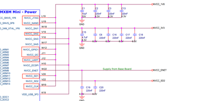

you can supply the NVCC_UART from the same power you give to uart convertor chip.
when you supply the 3.3v  to the NVCC_UART the IO will become 3.3v.
That is called power group or power domain.
Actually you can supply any voltage, such as 1.9v, what you want.

BiyongSUN
1.8V 3.3v
0 < 0.36 < 0.66
1 > 1.44 > 2.46
As I said before, the IO will follow the NVCC_UART power group/domain. Just supply it 3.3v.

Only_聆听
In my later hardware revision, I will change the power supply of this power supply, the current power supply is bundled with other power supplies.
Based on the current design, I have added the above level conversion circuit to the output position of Uart2 to fit my serial debugging tool.

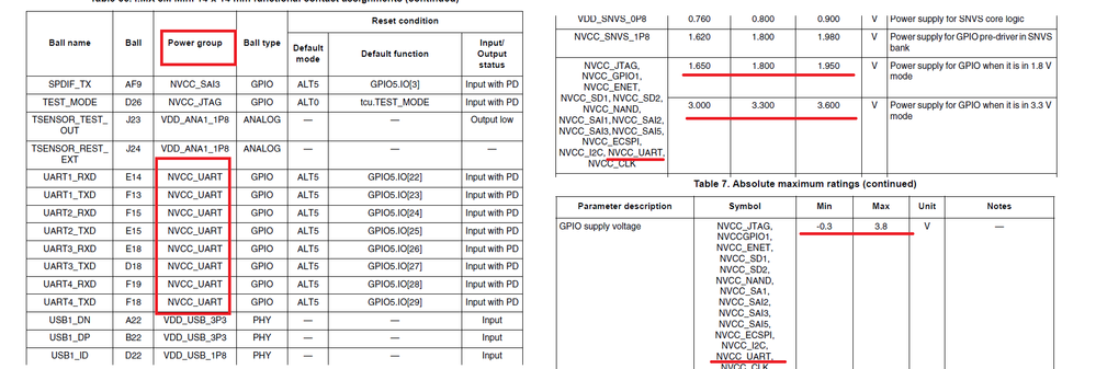

igorpadykov
Hi Li
it is defined by hardware,  please use Table 65. i.MX 8M Mini 14 x 14 mm functional contact assignments
column "Power group"   i.MX 8M Mini Applications Processor Datasheet for Consumer Products

Only_聆听
Hi Igorpadykov:
  • Thank you very much for your reply. I have successfully solved the problem.
  • My problem is caused by the level conversion circuit we added. Because the pull-up resistor is not added at the RX end, the data waveform is perfect, but the internal driving ability is not enough, and the chip still fails to recognize the data or the data is garbled.
  • After we added the pull-up resistance, everything worked
