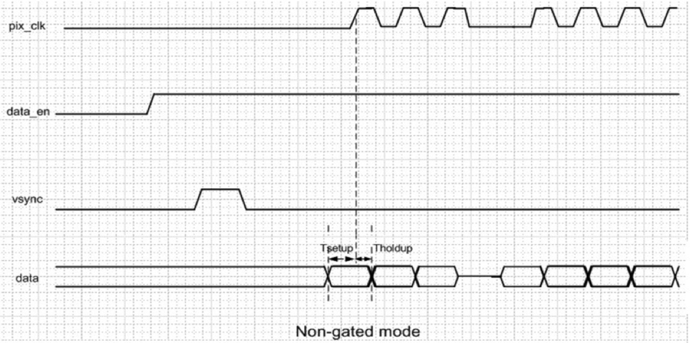

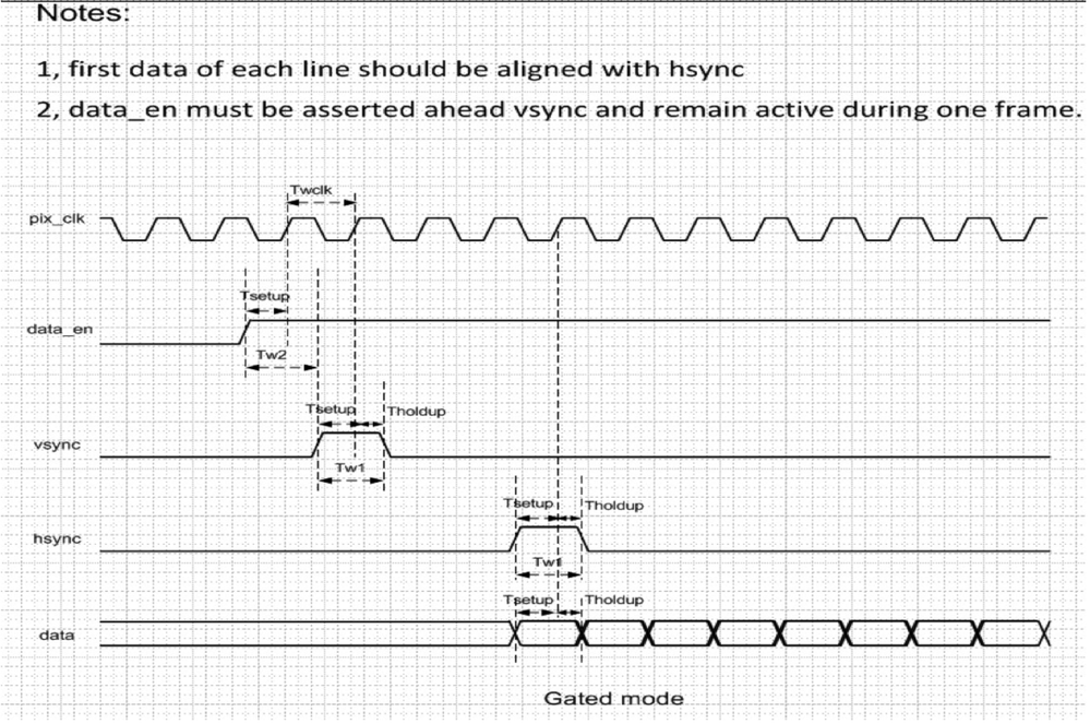

Is there a diagram anywhere of the timing required when using the CSI0_DATA_EN pin?  The Reference Manual and i.MX6 datasheets do not show the pin in any diagram or description that I've seen.
Furthermore, is there any configuration required to enable the DATA_ENABLE pin beyond setting it in the DTB (pinctl_ipu1_2) and setting the csi_param.data_en_pol?

For anyone else struggling with this, I received this diagram from FSL support:

Hi Allan
I am afraid such diagram is not available.
Answer on second qustion is no, in Freescale BSPs this DATA_ENABLE
signal is just set to correct value, so CSI could accept data.

Chip- should the DE be active-high or active-low?
3,303件の閲覧回数
igorpadykov
DE is active-high
