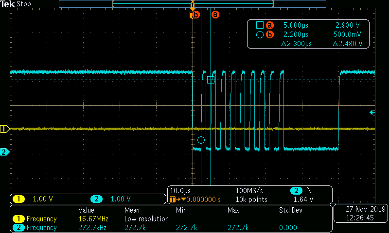

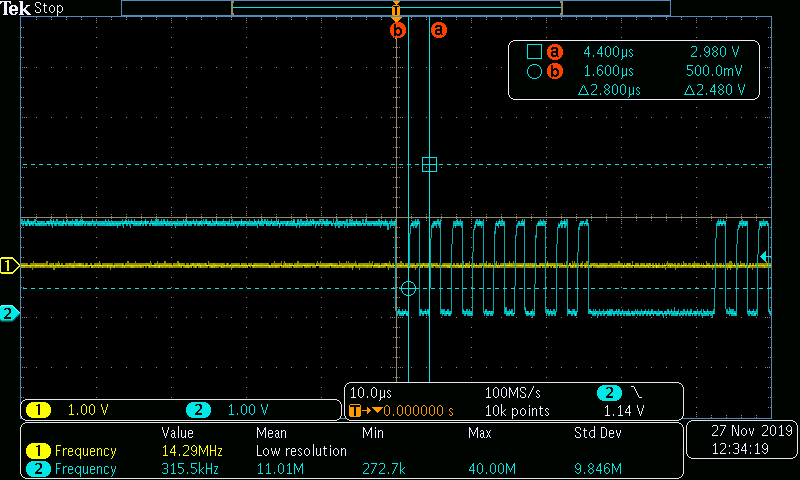

Customer would like to change i2c clock by modify device tree, but seems not work.
So we want to debug it by dump related register.
Is it right to dump below register for i2c1 clock because memtool return zero?
root@imx8mmevk:~# /unit_tests/memtool -32 0x3038AD00 1
E
Reading 0x1 count starting at address 0x3038AD00
0x3038AD00:  00000000
root@imx8mmevk:~# /unit_tests/memtool -32 0x3038AD80 1
E
Reading 0x1 count starting at address 0x3038AD80
0x3038AD80:  00000000
root@imx8mmevk:~# /unit_tests/memtool -32 0x3038AE00 1
E
Reading 0x1 count starting at address 0x3038AE00
0x3038AE00:  00000000
root@imx8mmevk:~# /unit_tests/memtool -32 0x3038AE80 1
E
Reading 0x1 count starting at address 0x3038AE80
0x3038AE80:  00000000
i2c-1
i2c-2
