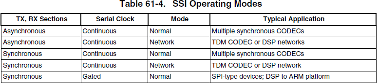

Which mode is used in i.MX6 SABRE-SD with WM8962?
Which mode is used in i.MX6 SABRE-AI with CS42888?

i.MX6 SABRE-SD uses SSI I2S slave with WM8962 and such
configuration is described in sect.61.8.1.4 I2S Mode i.MX6DQ Reference Manual
http://www.nxp.com/docs/en/reference-manual/IMX6DQRM.pdf
i.MX6 SABRE-AI with CS42888 does not use SSI, it uses another module - ESAI.

By dump SSIx_SCR can find out.
