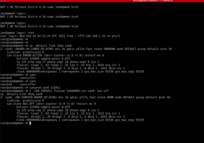

hello, I am using i.mx8qm mek for adas project. when the board sent the first message on can bus, the bus is going in off state if another node send the first message the system is working fine
log files
 error getting is
normal can status
can0: <NOARP,UP,LOWER_UP,ECHO> mtu 16 qdisc pfifo_fast state UNKNOWN mode DEFAULT group default qlen 10
    link/can  promiscuity 0
    can state ERROR-ACTIVE (berr-counter tx 0 rx 0) restart-ms 0
          bitrate 500000 sample-point 0.875
          tq 50 prop-seg 17 phase-seg1 17 phase-seg2 5 sjw 1
          flexcan: tseg1 2..64 tseg2 1..32 sjw 1..32 brp 1..1024 brp-inc 1
          flexcan: dtseg1 1..39 dtseg2 1..8 dsjw 1..8 dbrp 1..1024 dbrp-inc 1
          clock 40000000numtxqueues 1 numrxqueues 1 gso_max_size 65536 gso_max_segs 65535

hello,
the mentioned step is already done, but the issue is still there .
issue only from i.mx side while initiating the communication.
if the first message sends by the board that time bus is going in off state.

aksh9354
The device tree would still need to be modified to configure the pads and FlexCAN resources.
as per the above line mentioned in the modification of default device configuration   which modification we need to do in the device tree and what modification we need to do

igorpadykov
Hi aksh9354
in nxp linux releases flexcan is used by m4, so necessary to perform steps below:
https://community.nxp.com/t5/i-MX-Processors-Knowledge-Base/System-Controller-Firmware-101-Resource-...
Also please try latest nxp linux releases described on
https://www.nxp.com/design/software/embedded-software/i-mx-software/embedded-linux-for-i-mx-applicat...
