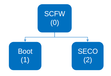

At boot time the system is initially configured in three partitions:
  • The first partition (SCFW) contains all the resources, pads and memory required by the System Controller Unit (SCU) to execute the System Controller Firmware.
  • The second partition (SECO) contains all the resources required by the Security Controller to execute.
  • The third partition (Boot) contains all of the remaining resources, pads and memory available for the whole system.

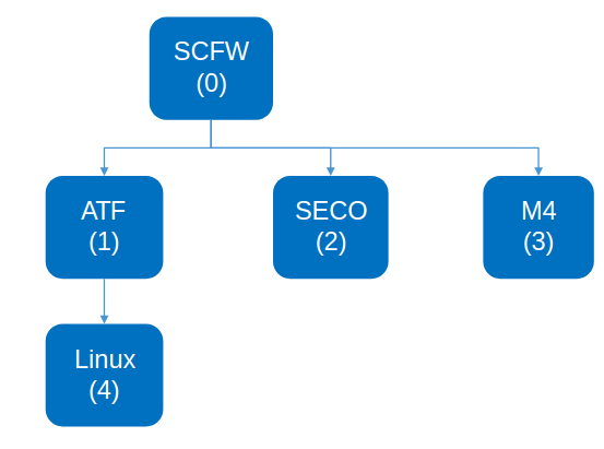

Once Linux and the M4 boot a typical use case is to partition the system as follows:
In this case the boot partition is split into the ATF/Linux partition and the M4 partition.
The ARM Trusted Firmware environment add a layer of abstraction to secure the environment and it is assigned cores and memory to execute in this privileged state, all the remaining resources, pads and memory are assigned to the Linux partition.
The M4 partition contains all the resources required by the M4 to execute, as well as the resources required by the application running on the M4.

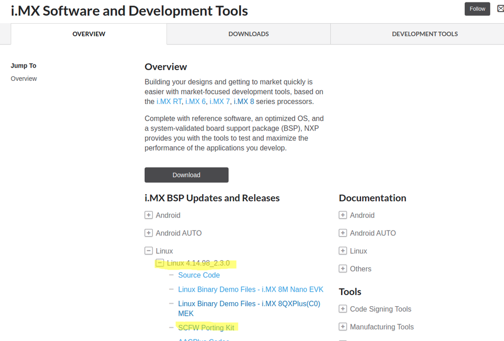

The SCFW porting kit provides an example on doing boot time configuration at the board.c file under platform/board/mx8q<x or m>_<your board>/board.c, board_system_config is the function in charge of partitioning the system at boot time.

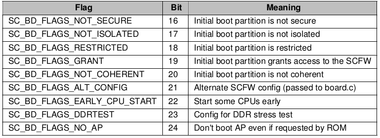

From the sc_fw_port.pdf (porting guide) document included in the porting kit - Boot Flags chapter:
Here are a few important points to highlight:
  • The code will only execute if the SC_BD_FLAGS_ALT_CONFIG is set under the boot flags (more details in the Usage chapter of the sc_fw_port.pdf), the flags are set while building the image with mkimage. An example is provided to build an image with partitioning enabled:
flash_linux_m4: $(MKIMG) mx8qx-ahab-container.img scfw_tcm.bin u-boot-atf.bin m4_image.bin
 ./$(MKIMG) -soc QX -rev B0 -append mx8qx-ahab-container.img -c -flags 0x00200000 -scfw scfw_tcm.bin -ap u-boot-atf.bin a35 0x80000000 -p3 -m4 m4_image.bin 0 0x34FE0000 -out flash.bin‍‍‍‍‍‍‍‍‍‍‍‍
The example above can be found under your i.MX8 variant on the soc.mak file, in the example above the SC_BD_FLAGS_ALT_CONFIG flag is being set by -flags 0x00200000 and the partition for the M4 is defined as the third one by the -p3 parameter.
Without the -flags 0x00200000 (setting SC_BD_FLAGS_ALT_CONFIG) parameter on mkimage NO partition happens at boot time, if the target used to build the image does not set this flag, then the SCU does not partition the system.

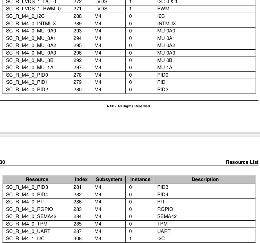

From sc_fw_api_qm_b0.pdf Resource List:

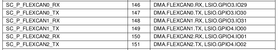

From sc_fw_api_qm_b0.pdf Pad List:
Not all resources are available on all variants, for details on what resources/pads are available on your device please refer to its respective api document.

The resource list in the sc_fw_api_qm_b0.pdf document shows what resources belong to the M4 subsystem:
Next some other resources required by the M4 are assigned to its partition, such as MUs used to communicate with the other cores, timers and the IRQ steer resource.
In this case we are interested on having the FlexCAN resources/pads on the A cores side, these resources/pads are being assigned to the M4_1 partition as can be seen on the previous partitions dumps and the following code:

So we just need to remove the following lines from the board.c:
BRD_ERR(rm_set_resource_movable(pt_boot, SC_R_CAN_0,
 SC_R_CAN_2, SC_TRUE));
 BRD_ERR(rm_set_pad_movable(pt_boot, SC_P_FLEXCAN0_RX,
 SC_P_FLEXCAN2_TX, SC_TRUE));
That way the resources/pads won't be marked to be moved to the M4_1 partition and they will be left on the pt_boot partition (A core partition). If a resource needs to be added to the M4 partition just add the calls to rm_set_resource_movable to assign it.
Now we just need to rebuild the scfw and our image:
make qm R=B0 B=mek M=1‍‍‍‍
Then on mkimage (with the flags set modification above):
make SOC=iMX8QM flash‍‍‍
Flash the sd card with the new image:
sudo dd if=iMX8QM/flash.bin of=/dev/mmcblkXX bs=1k seek=32
Now when the dump is done we can see that the FlexCAN resources and pads belong to the same partition as the A cores (partition 6).
*** Resources ***********************************
Partition: 6
FTM_1
CAN_0
CAN_1
CAN_2
DMA_1_CH0
*** Pads ****************************************
Partition: 6
COMP_CTL_GPIO_1V8_3V3_GPIOLHT
FLEXCAN0_RX
FLEXCAN0_TX
FLEXCAN1_RX
FLEXCAN1_TX
FLEXCAN2_RX
FLEXCAN2_TX
COMP_CTL_GPIO_1V8_3V3_GPIOTHR
The device tree would still need to be modified to configure the pads and FlexCAN resources.
