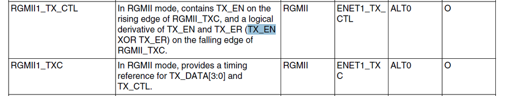

I found in RM of imx7d, some MII interface PIN is missing or wrong.
example:
TX_CLK should be use as input ,but in RM it's ouput.
and there is no ENET1_TX_EN pin.
RGMII_TX_CTL is similar to TX_EN, but it used for RGMII only
Does anyone know the detail of pin assignment for MII interface?

1. There is the typo in the manual regarding the ENETx_TX_CLK signal. Actually, it is input in the MII mode.
2. There is the typo in the manual regarding the RGMIIx_TX_CTL signal. Actually, in MII mode it operates as ENETx_TX_EN.
