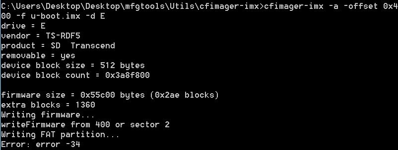

scott10
Hi Yuri,
I downloaded the cfimager-imx utility from the link you provided and placed it in a folder containing u-boot.imx. When I try to execute the command you provided, I get error -34.
I know the SD card works because I am able to use the method stated in my previous comment using cfimager (not cfimager-imx) to burn the image to the SD card. This allows me to boot U-Boot on my target system.
I've been experimenting with different commands for the cfimager-imx utility and I can never get it to format the SD card and write to it. Do we know what error codes -34 and -37 mean? More importantly, do we know how to fix this issue?
I can always fall back to the method stated in my previous comment to achieve my desired result, but finding a solution to this issue would not only help me, but it may help others in the future too.
Thank you,
Scott
8,260 Views
Yuri
Please try to clear the SD using Linux command  dd, as shown below (an example)
$ sudo dd if=/dev/zero of=/dev/sda bs=512 count=1000
As for errors :
STERR_FAILED_TO_WRITE_SECTOR                                =     -37
STERR_UNABLE_TO_CALCULATE_CHS                               =     -34
~Yuri.
8,260 Views
scott10
Thank you Yuri. The cfimager-imx application works after writing the zeroes to the card.
Scott
