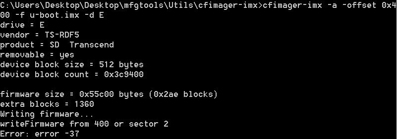

I believe cfimager-imx is a different utility than the cfimager I was using. I was able to obtain a copy of cfimager-imx 1.2 copyright 2005 SigmaTel. I tried executing the command you listed above and it returned an error code: error -37.
Do you know what might be causing this error? Perhaps I have an obsolete version of cfimager-imx?

Here is a screenshot of my output:

Please try to clear the SD using Linux command  dd, as shown below (an example)
$ sudo dd if=/dev/zero of=/dev/sda bs=512 count=1000
As for errors :
STERR_FAILED_TO_WRITE_SECTOR                                =     -37
STERR_UNABLE_TO_CALCULATE_CHS                               =     -34
~Yuri.

scott10
Thank you Yuri. The cfimager-imx application works after writing the zeroes to the card.
