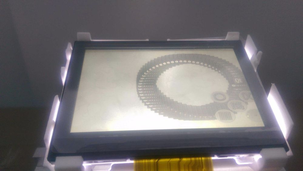

michaelwiesent
I have exactly the same problem as in this thread EGLFS ugly rendering. .

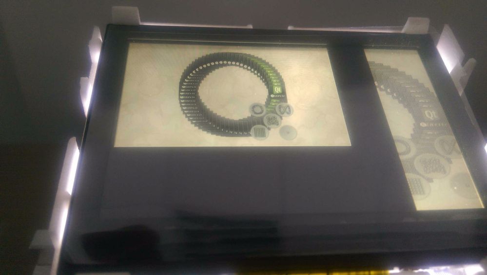

In my case i have a display with 800x480 pixel. EGL renders obviously 1000x480 pixel. The 200 pixel are shifted like in the picture below but when i change the parameter bits_per_pixel from 24 to 32 bit (/sys/class/graphics/fb0/bits_per_pixel) the shift will not be visible on the left side. I will simply not be shown anymore because of the end of the display. The rendering failure still exists.
Which init file do jamesbone mean and where can i find this file?
Here are some pictures from my side to give you a better felling what is happening to my system:
Picture 1: this picture shows the effect like above with visible shift
Picture 2: here we can see the same effect but the pixel depth is changed from 24 to 32 bit

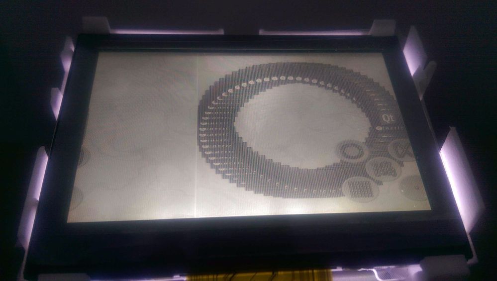

Picture 3: this picture shows the output, when i start the example with linuxfb (but in our project we can´t use linuxfb because we use opengl es 2)

I also invested some time in getting into the platform coding and the framebuffer. After this i have a guess but don´t know how or where to fix it. When linuxfb is used there are only the RGB values in the framebuffer. It looks like this
R G B R G B R G B ...
When I use the platform eglfs it seems that there is the color format RGBA so it looks like this
R G B A R G B A R G B A ...
The alpha channel has always the value 0xFF. I checked this with hexdump.
I think that the driver (should be vivante) which is interpreting this data do not know about this RGBA format und interpet it like a RGB format. I tried to set the boot parameters to RGBA32 or RGBA8888 but there was no change. The result could be the following:
framebuffer                              R G B A R G B A R G B A
graphic driver interpretation     R G B R G B R G B R G B
This could be the reason why the image is around 200px larger. The basic width is 800px.
I´m able to cross compile the libqeglfs.so. Therefore I added some debugging information for a better understanding how this plugin works. So I can change anything of this plugin. Can anyone tell me where I can set the color width so that only RGB is set to the framebuffer?
UPDATE:
I think i have to change the configuration of the attribute EGL_BUFFER_SIZE or EGL_NATIVE_VISUAL_TYPE from 32 to 24. Where can i do that?
