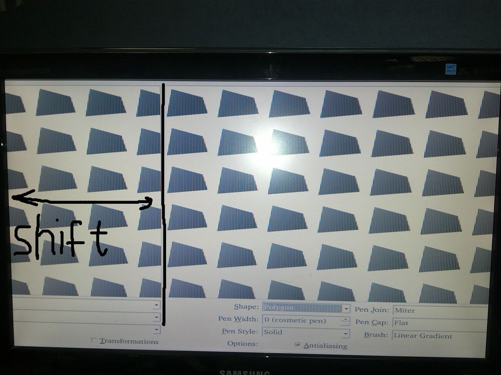

Hi everybody!
I tried to build and start Qt example "Basic Drawing Example" for iMX6.
Application started with command
.basicdrawing -platform eglfs
Application rendered in gray colors with shift and with white vertical lines.
Any advice please?
In what direction looks?
Thanks!

I believe the shift it is related to configuration of the window space to draw in EGL, you have may have a resolution of the display and a different resolution setup in the EGL window.  Check the init file, review the examples in the VDK tool.

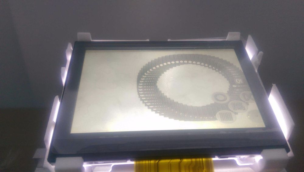

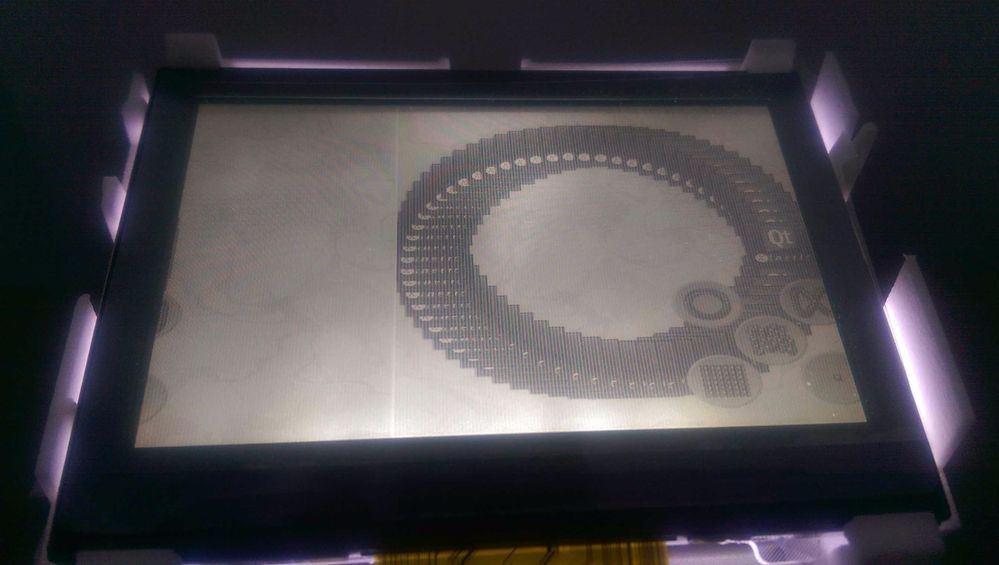

I have exactly the same problem.
In my case i have a display with 800x480 pixel. EGL renders obviously 1000x480 pixel. The 200 pixel are shifted like in the picture above but when i change the parameter bits_per_pixel from 24 to 32 bit (at /sys/class/graphics/fb0/bits_per_pixel) the shift will not be visible on the left side. I will simply not be shown anymore because of the end of the display. The rendering failure sill exists.
Which init file do you mean and where can i find this file?
Here are some pictures from my side to give you a better felling what is happening to my system:
Picture 1: this picture shows the effect like above with visible shift
Picture 2: here we can see the same effect but the pixel depth is changed from 24 to 32 bit
Picture 3: this picture shows the output, when i start the example with linuxfb (but in our project we can´t use linuxfb because we use opengl es 2)
