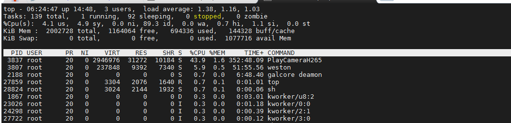

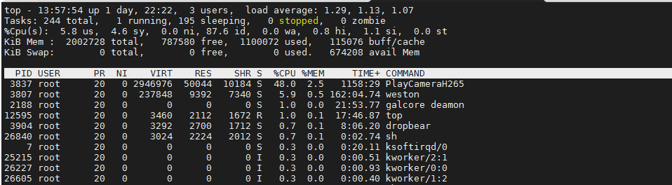

       Why does the application I wrote with gstreamer run on the imx8mm platform will have a memory leak, the application is as follows:
After about 100 hours, the memory of the development board is exhausted. The memory consumption is shown in the attached screenshot(PlayCameraH265 is my application), What is the reason?2020-12-01.png2020-12-02.png

Hi Liubin2,
   gstreamer是比较容易造成内存泄漏的。
   这里是同行写的注意事项,您可以参考一下。
https://blog.csdn.net/yingmuliuchuan/article/details/79347773?utm_source=blogxgwz8

        关于gstreamer内存泄漏的,问题已经查明,是GPU模块的驱动程序有点问题导致的泄漏,打了个补丁更新一下内核就好了。谢谢!
