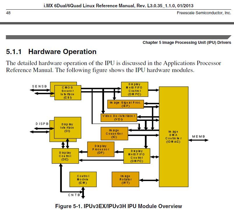

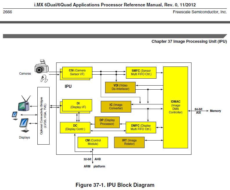

Hello...?
I am on working on image enhancement of i.MX6Q camera interfaces.
I have found some confusing on freescale's documents.
There are tow documents.
1. i.MX 6Dual/6Quad Linux Reference Manual, Rev. L3.0.35_1.1.0, 01/2013
2. i.MX 6Dual/6Quad Applications Processor Reference Manual, Rev. 0, 11/2012
But the explanation of IPU block is different by each other,
especially ISP which is on between CSI and IDMAC described at Linux Reference Manual.
Can you let me know which one is right.. or some differences by Chip version or Chip series..?
Thank you in advance.
Mach.
Here it is the two block diagrams.

Yuri
This is old story about the ISP :
On iMX5x IPU, there is a module called ISP, which was not fully verified, so in the iMX5x
documentation, the ISP section had been removed.  And on iMX6, the ISP module had been
removed.
