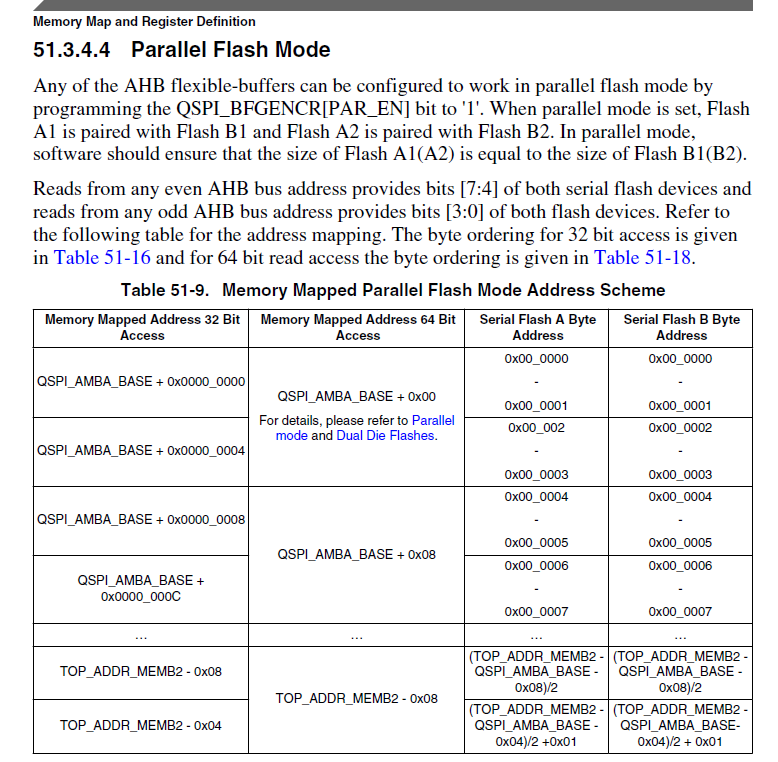

QSPI nor uses quit different way to access. The QSPI controller has register to map the address.
Of course, if really want to separate it. You need to know which mode of QSPI, Individual Flash Mode? Parallel Flash Mode?
The QSPI nor flash connect to the QSPI controller(here is imx QSPI interface) is a flash supports QSPI mode. not a spi nor flash. this kind of flash need to configure the settings to use it.

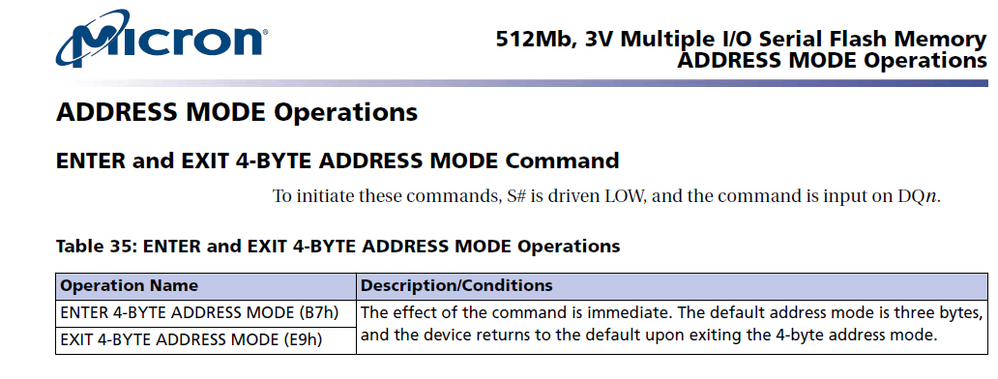

I am using Micron flash MT25QL512ABB.
In the datasheet of MT25QL512ABB, I came across the line "The 3-byte address mode can only access 128Mb of memory". And then I got this question whether we can use 3B for accessing 64MB or 1GB flash or not.
As per your reply, I understood that the 3B and 4B are used based upon the flash size and are applicable only in the case of SPI-NOR Flash.
The 3B and 4B are not applicable in the case of QSPI-NOR Flash. That means I can use 3B and do read, write, program, operations for 64MB/512MB/1GB, or 2GB sized NOR Flash.
Please correct me if my understanding is wrong.

If the spi nor flash > 16MB(128Mb), it certainly has command to switch to 4B mode.
But QSPI can connect to 4 spi nor flash working together. That is to say, you can use up to  64MB under  3B address mode(actually, no such concept under qspi mode).
the data sheet says "The 3-byte address mode can only access 128Mb of memory"
128Mb, the b is lowercase. it is bit not Byte. it is  16MB.
If you can find  4G  spi nor, you can use the 4B address  to access it as a standard spi nor.
But the Soc, here is i.MX6UL, has design to map the 256MB QSPI linear address.
That is to say is you have a spi nor 512MB, you can use the whole device as a standard spi nor flash. But only can use 256MB(half) for QSPI for this device.
Because QSPI needs linear address.  QSPI simulates as parallel nor, as sdram-like device.
If you have a SOC, can map  4G for QSPI in the memory map design, you can use the 4G QSPI by this kind of SOC.
It supports the dual/quad io protocol for QSPI nor.

The address region for QSPI  is still   3B/4B spi nor region, If you read the  protocol spec.
The protocol spec is the common, not only for the i.MX.
The figure shows the 24bit address.
