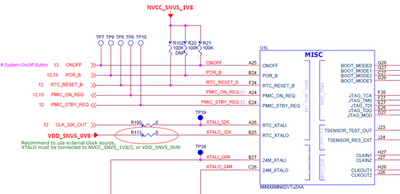

We are facing the same issue of VDD_SNVS_0V8 overvoltage during the Boundary Scan mode.
VDD_SNVS_0V8 voltage:
- BOOT_MODE3_0 set to "0010" (Boot from emmc): VDD_SNVS_0V8 = 0.80V (ok)
- BOOT_MODE3_0 set to "1111" (Boundary Scan): VDD_SNVS_0V8 = 0.95V (overvoltage)
Measuring the VDD_SNVS_0V8 when the BOOT_MODE3_0 signals are at "1111", a frequency of ~32kHz over the 0.8V level is noted.
RTC_XTALO signal is connected to the VDD_SNVS_0V8, according to the IMX8MNIEC.pdf ("RTC_XTALO should be directly connected to VDD_SNVS_0P8").
We are concerned because VDD_SNVS_0V8 reaches the Absolute Maximum Voltage (0.95V) during the Boundary Scan mode.
Is there any solution to this issue?
Note: We did an exploratory test by adding a 1k Ohms resistor between RTC_XTALO and VDD_SNVS_0P8. It solves the unwelcome voltage. But it does not comply with the datasheet recommended circuit connection.
This test shows that the RTC_XTALO pin causes overvoltage on the VDD_SNVS_0P8.
3,808 Views
nxf56472
NXP recommendation is to disconnect RTC_XTALO from VDD_SNVS during Boundary Scan mode. Note, they should still be connected directly during normal boot/operation, this recommendation only applies to Boundary Scan mode.
In Boundary Scan Mode,  RTC_XTALO pin has 32KHz clock output that overlays with VDD_SNVS. Please cut off the input from VDD_SNVS to RTC_XTALO in Boundary Scan Mode.
On iMX8MNano EVK board, this can be accomplished by removing R113.
