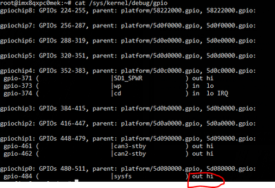

Customer would like to manipulate ESAI0_TX0 as GPIO (LSIO_GPIO0_IO04) by sysfs, but doesn't work.
Then try to dump mux_mode of i.MX8X register ESAI0_TX0 via memtool to make sure setting is right.
Reference manual only shows offset 0x2_31c0h, but no base address of IOMUX.
So what is the memory map address of i.MX8X IOMUX?
