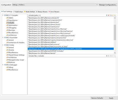

I'm learning how to use EAP feature from SDK. Created a baremetal project with adding only EAP and Maestro framework.
I added to main #include "EAP_Parameter_LoudnessMaximiser.h" and get a bunch of errors in that header
unknown type name 'LVM_ControlParams_t' EAP_Parameter_LoudnessMaximiser.h /MIMXRT1176_Project_2/EAP/Example_Application/CONFIG_HEADER line 104 C/C++ Problem
unknown type name 'LVM_EQNB_BandDef_t' EAP_Parameter_LoudnessMaximiser.h /MIMXRT1176_Project_2/EAP/Example_Application/CONFIG_HEADER line 25 C/C++ Problem
unknown type name 'LVM_EQNB_BandDef_t' EAP_Parameter_LoudnessMaximiser.h /MIMXRT1176_Project_2/EAP/Example_Application/CONFIG_HEADER line 40 C/C++ Problem
unknown type name 'LVM_InstParams_t' EAP_Parameter_LoudnessMaximiser.h /MIMXRT1176_Project_2/EAP/Example_Application/CONFIG_HEADER line 59 C/C++ Problem
What have I missed? I actually don't see any file in the project which can be precompilied EAP library. Aswell as libEAP_releaseNote.txt in SDK.  I have felt like SDK gives me headers but I need to find lib somewhere, I can't figure out.

Please make sure that the include path is set in your project configuration:
It will be convenient if you start from an SDK example since the necessary settings were already set.

Burjak
Hello, Omar.
Thank you for your answer. You helped my case. MCUXpresso created needed includes that I see on your picture. But in my case, I created a bare-metal project via MCUXpresso wizard.
But you recommended to me use an example from SDK. There are no EAP examples, but 4 examples for maestro_framework. I imported and saw two new files in the project directory. I copied them to my bare-metal project and at least it was compiled.
Maybe it's an issue, and these two files should be in the project even when I created it via wizard?
