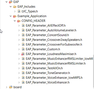

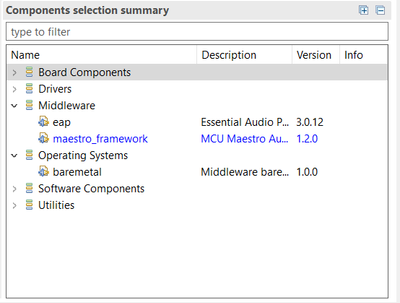

I'm learning how to use EAP feature from SDK. Created a baremetal project with adding only EAP and Maestro framework.
I added to main #include "EAP_Parameter_LoudnessMaximiser.h" and get a bunch of errors in that header
unknown type name 'LVM_ControlParams_t' EAP_Parameter_LoudnessMaximiser.h /MIMXRT1176_Project_2/EAP/Example_Application/CONFIG_HEADER line 104 C/C++ Problem
unknown type name 'LVM_EQNB_BandDef_t' EAP_Parameter_LoudnessMaximiser.h /MIMXRT1176_Project_2/EAP/Example_Application/CONFIG_HEADER line 25 C/C++ Problem
unknown type name 'LVM_EQNB_BandDef_t' EAP_Parameter_LoudnessMaximiser.h /MIMXRT1176_Project_2/EAP/Example_Application/CONFIG_HEADER line 40 C/C++ Problem
unknown type name 'LVM_InstParams_t' EAP_Parameter_LoudnessMaximiser.h /MIMXRT1176_Project_2/EAP/Example_Application/CONFIG_HEADER line 59 C/C++ Problem

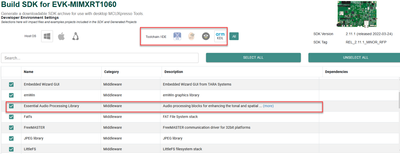

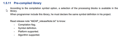

What have I missed? I actually don't see any file in the project which can be precompilied EAP library. Aswell as libEAP_releaseNote.txt in SDK.  I have felt like SDK gives me headers but I need to find lib somewhere, I can't figure out.

Thank you for your answer. You helped my case. MCUXpresso created needed includes that I see on your picture. But in my case, I created a bare-metal project via MCUXpresso wizard.
But you recommended to me use an example from SDK. There are no EAP examples, but 4 examples for maestro_framework. I imported and saw two new files in the project directory. I copied them to my bare-metal project and at least it was compiled.
Maybe it's an issue, and these two files should be in the project even when I created it via wizard?
Thank you again, you helped me.
