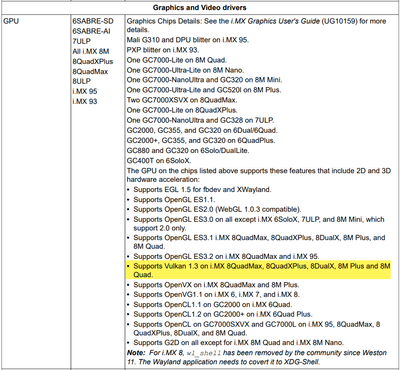

Hi Mike, thx for the reply. Is Vulkan driver included in standard yocto Linux build already? Or I need to build with a specific image to include it? I am currently building with “imx-image-multimedia”. Thank you
4,534 Views
Hui_Ma
Please refer latest i.MX Yocto Linux BSP v6.6.52_2.2.0 release note with below info:
Wish it helps.

Thank you Mike. Based on following document:
https://www.nxp.com/docs/en/user-guide/IMX_GRAPHICS_USERS_GUIDE.pdf
It seems that IMX8 nano, and IMX95 also support Vulkan. However, these two devices are not shown in the Linux release note, the list that you showed. Would you please help to confirm if these two devices are currently supported?
4,480 Views
Hui_Ma
You are right. I.MX8M Nano and I.MX95 also support Vulkan 1.3 driver.
I had confirmed with i.MX product team that the Yocto release note has document issue missing both product with Table 8 about GPU relevant content.
We will follow up to correct that release note.
Mike
